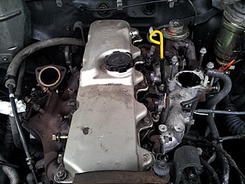

    I have started to dismantle the poorly engine in my truck.
    Got as far as removing belts, fan, air intake to and from turbo etc. Rocker cover is clear, now starting to clear timing belt cover.
    When I tackle the manifolds, am i better trying to get them off as complete as possible?
    Which part of the ( ithink its the egr pipe) that runs round back of engine to intake manifold is best to break to obtain a new gasket if it gets rebuilt.

    Update...
    Now removed as much to the exhaust side as possible without touching turbo. Will need a new heater matrix though, bent pipe getting the hose off.....
    Exhaust manifold nuts are now soaking in oil, but hopefully they will come free like every other bolt so far.
    The intake side looks a little cramped and could really use a little advise before I tackle that one.

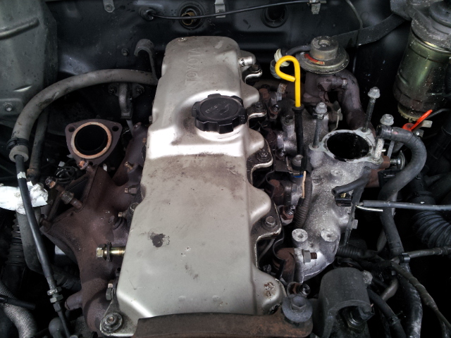

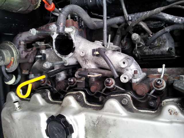

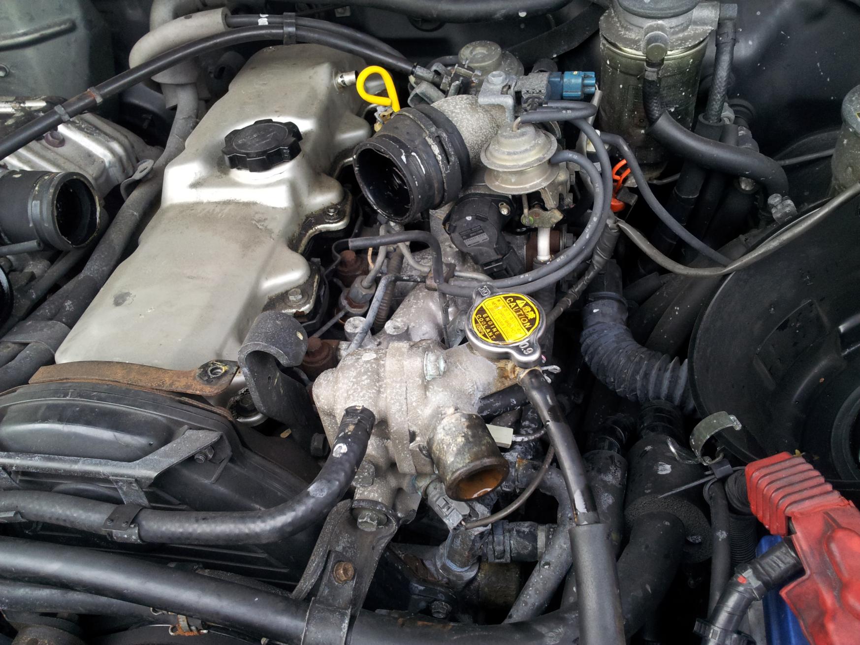

            A little bit more removed.
            Hi. Got the turbo, inlet throttleassembly and injector lines off.
            Which is the next best bit to remove. Can see the EGR line from exhaust manifold
            to intake maifold. Before i can start taking manifolds off i obviously need to remove it.
            Under where the EGR comes into the inlet I can feel what I think is a set of valves. Can't see them for the tight space. Would hopefully be in a position to lift the head next weekend. Also what size are the sockets for the head bolts, will need to by a torx socket big enough.

              Head bolts need a 14mm 12 point socket.
              For the ERG pipe there are two 12mm nuts on the back exhaust manifold, the lower one is fiddly to get off, a ratchet spanner is a godsend on it, take your time and get a good fit with the ring end of a spanner as if you round the nut off you'll really struggle with it. The side that bolts the inlet is obvious and easy.

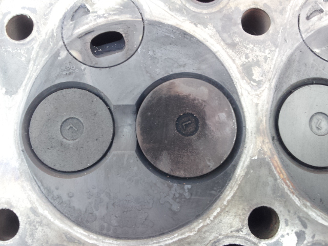

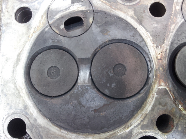

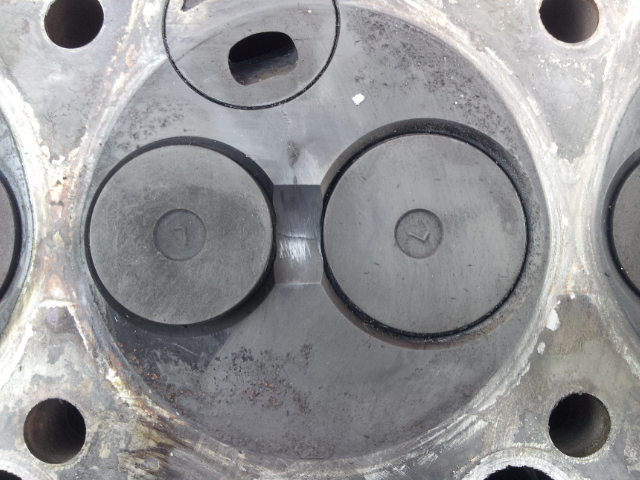

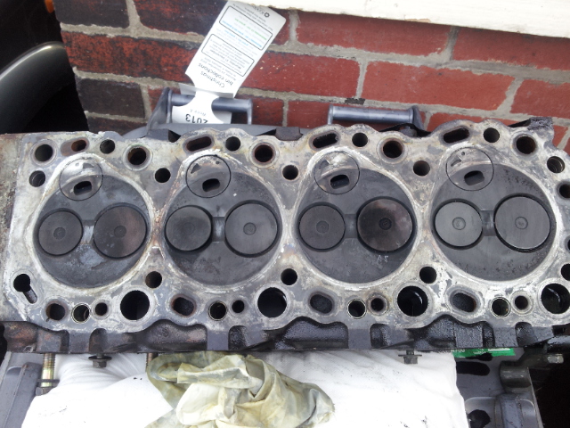

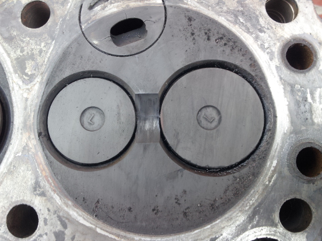

                          Finally got the head off. Came off quite easy really when you don't miss a bolt.....
                          Must admit when I was undoing the bolts a couple seemed to undo a lot easier then the rest as though they hadn't been torqued down properly, or the bolts had stretched more than normal.
                          Pictures are attached and looks like 2 & 4 are goosed. Also the ones with crack s in, there is a lot of pitting in the head as well, as can be seen.
                          Looks like a lexus conversion is on the way......more questions about that later.
