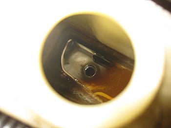

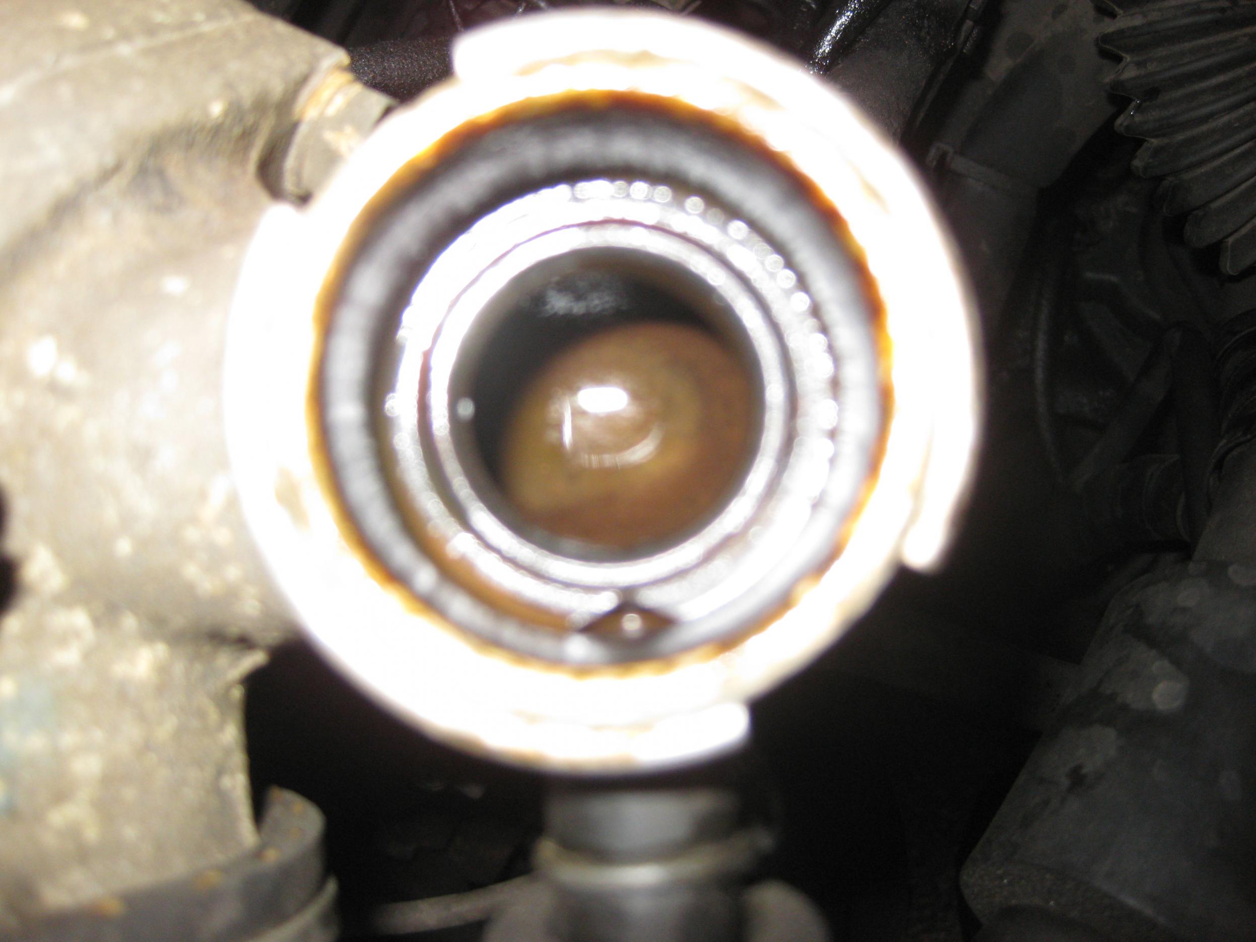

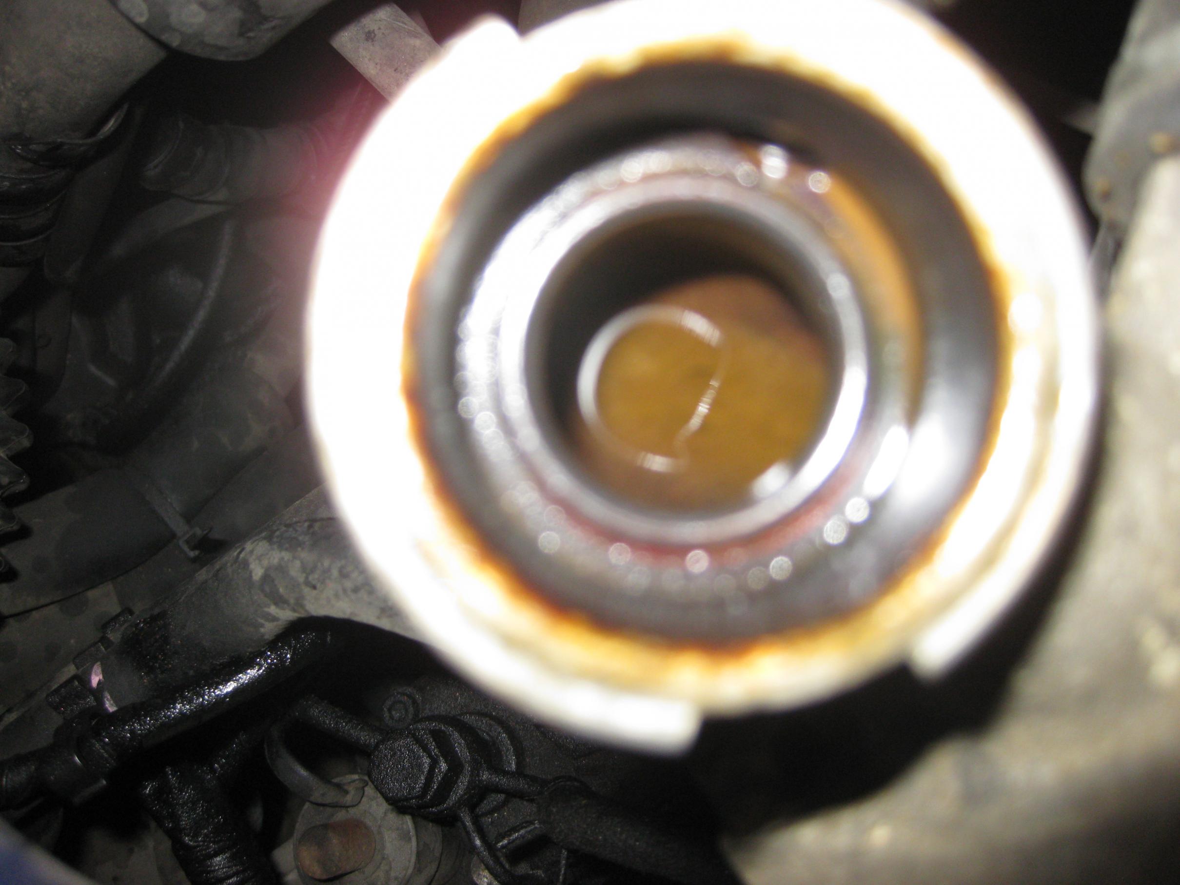

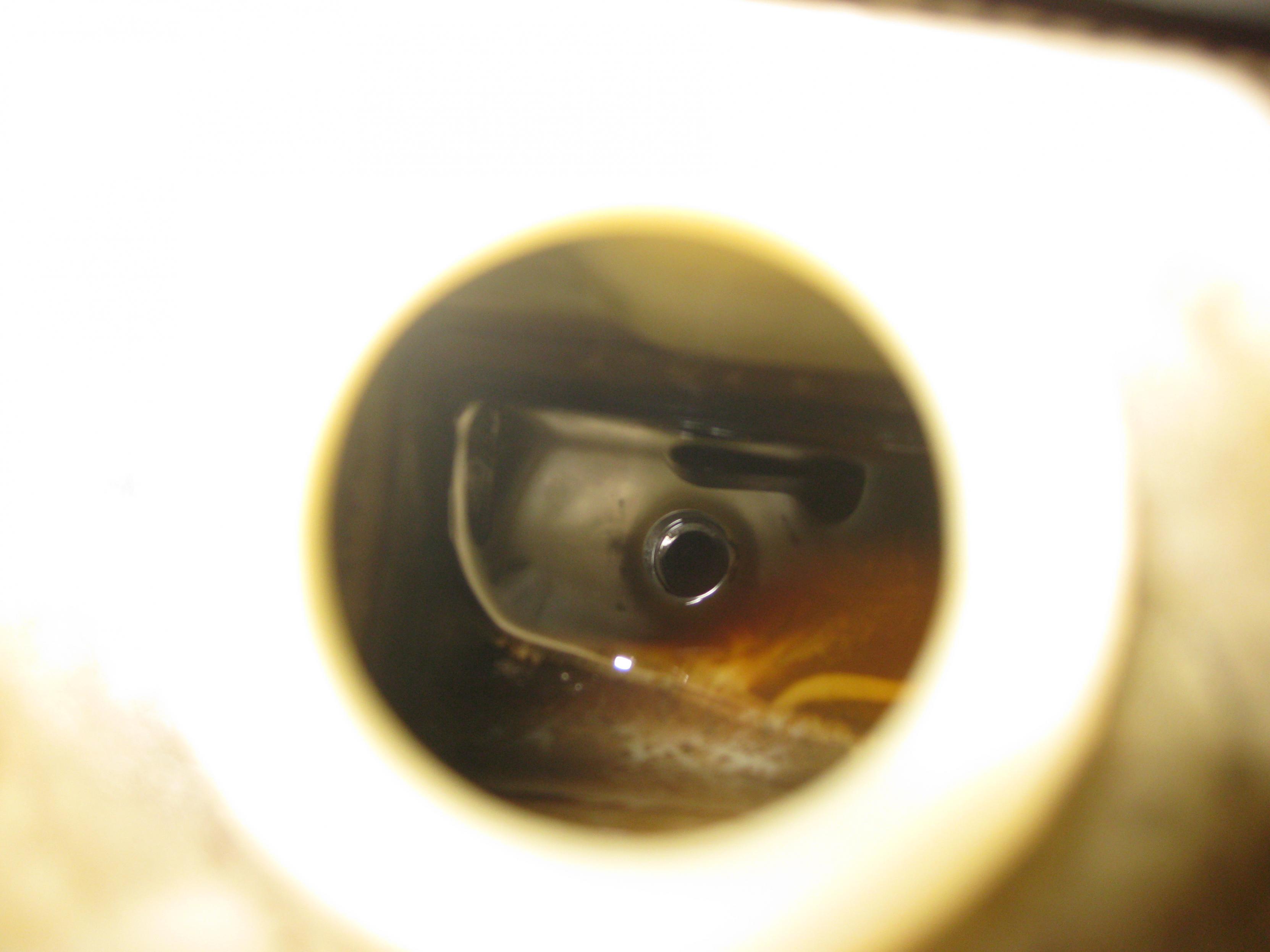

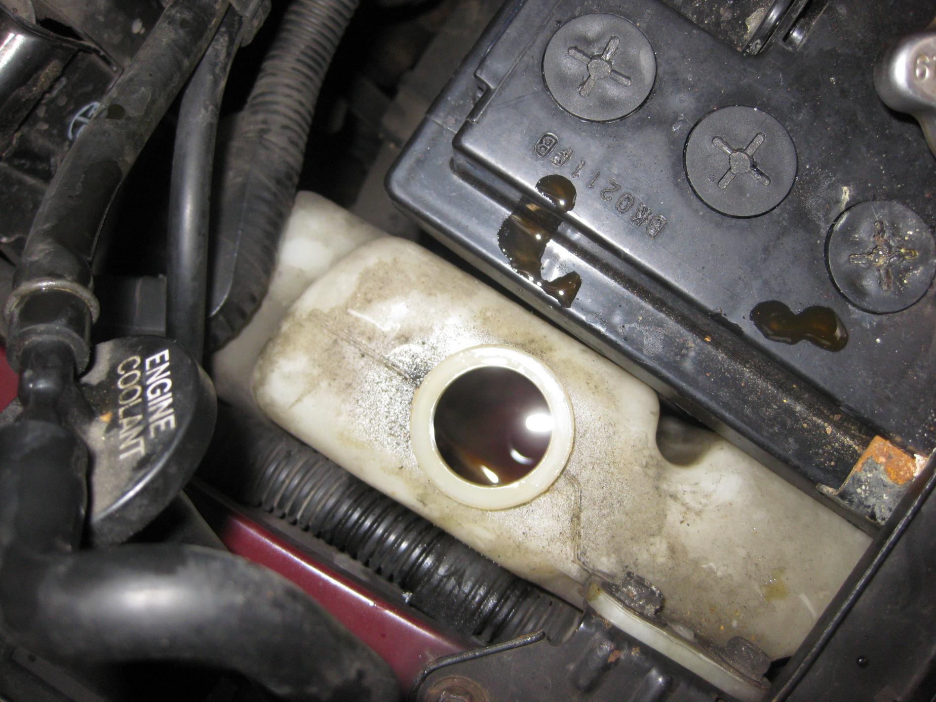

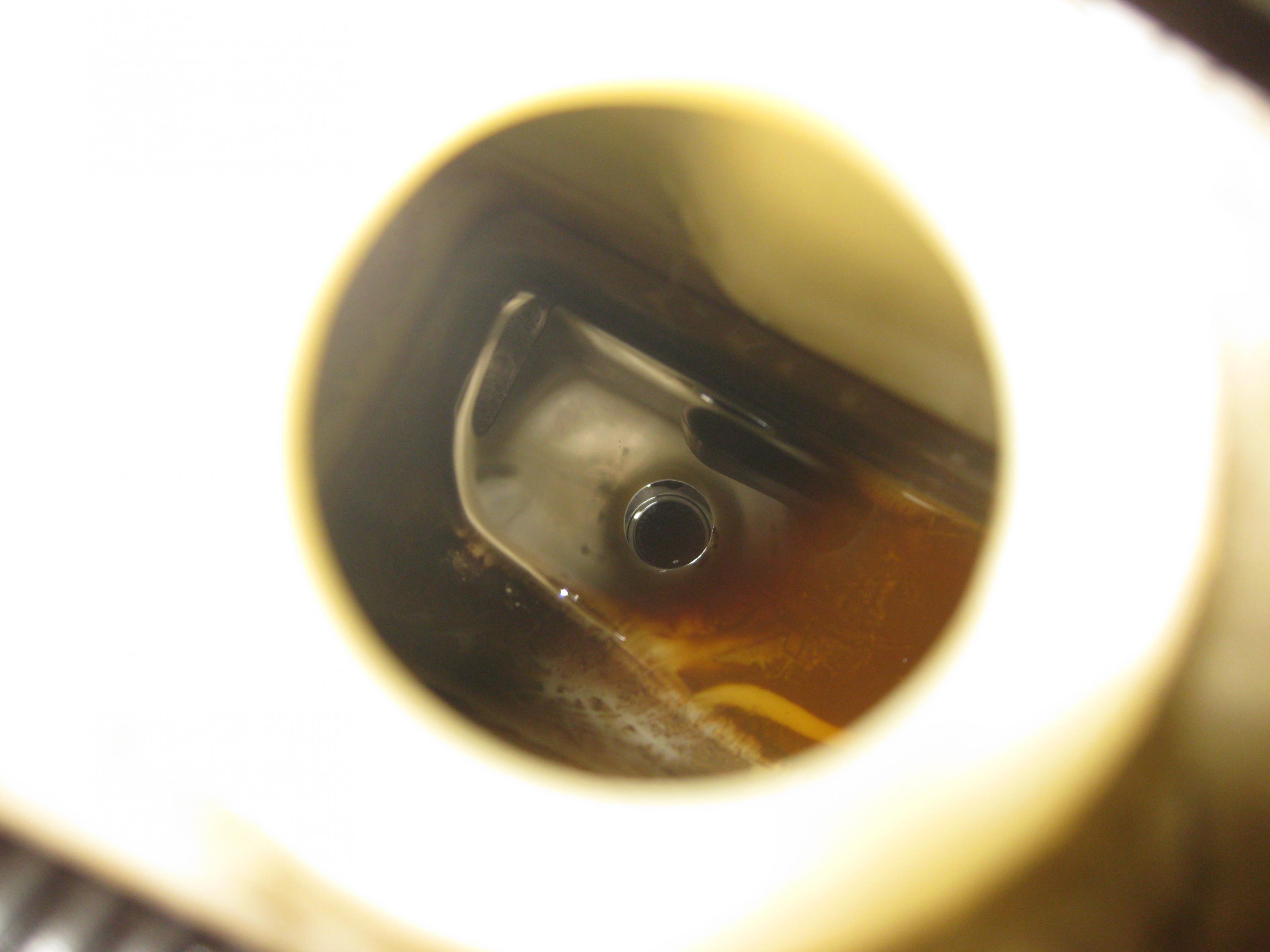

              Hello
              so now I've seen after all liquids (oils) and also pictures of the white water tank and the water filling a clip made for the engine. The white reservoir is now not longer quite half full and time I've run the engine. As is not suggested I drove a few meters to see what happens now, it's so I've ridden all 35 km without half the temperature on the display went.
              When I made the motor then I heard how it blubberte in the white tank, what can this be, or don't like the Toyota of Germany (which I can understand)
              Greeting
              Martin
              I hope you realize what in the photos!
              Red Monster, KZN130 3,0 Litre Diesel
                You should have coolant in the white tank.
                Did you see any coolant in the white tank?
                I have mine filled about half way, then I can tell if it is losing water, the overflow tank is there to catch the water that is extra to the cooling system needs.
                As the water gets hotter it expands and the expansion tank is there to catch this water, when the system cools down it is supposed to suck this water back into the cooling system.
                You need to put some coolant into the expansion tank probably about half full.
                I cant quite see from the pictures but is the water oily or just brown from rust?
                Eat.Sleep.Surf.Repeat.
                  Hello
                  first thank you.
                  The water is slightly rusty (will still complete the water make new). The white tank is not half full, would say about 1/3 only, which is probably too little, he may not be well also but completely full.
                  Now, I will fill up with water and drive again. Let's see what then is because he so as I already wrote today perfectly run is (no overheating).
                  Just a real mystery.
                  Greeting
                  Martin
