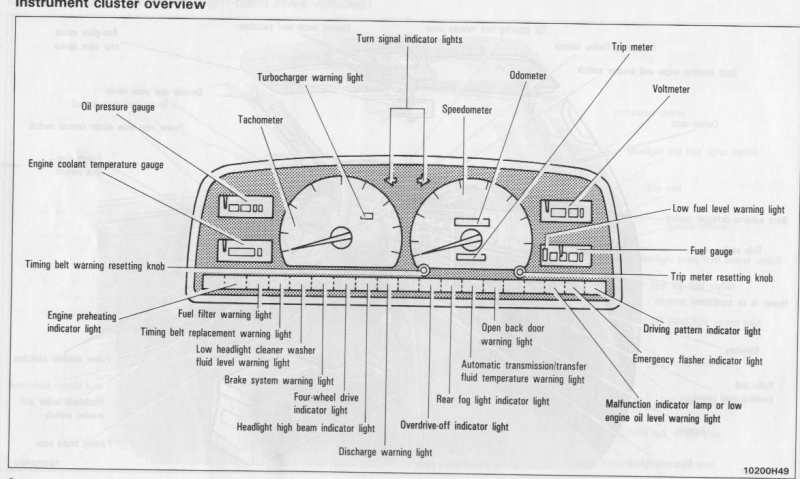

    New to forum. Have just bought a 1992 2.4 manual SSR-X. Had a read of the forum and saw a lot of people talking about turbo lights. Never seen one on mine. Investigated the dashboard and found should have a parking brake light. Fixed that with a bit of solder onto broken switch wire. Got me thinking....what else is not lighting up. Anyone got a dashboard picture ?
    here you go & welcome to SURFDOM
      Thanks Marky. Will study it tonight.

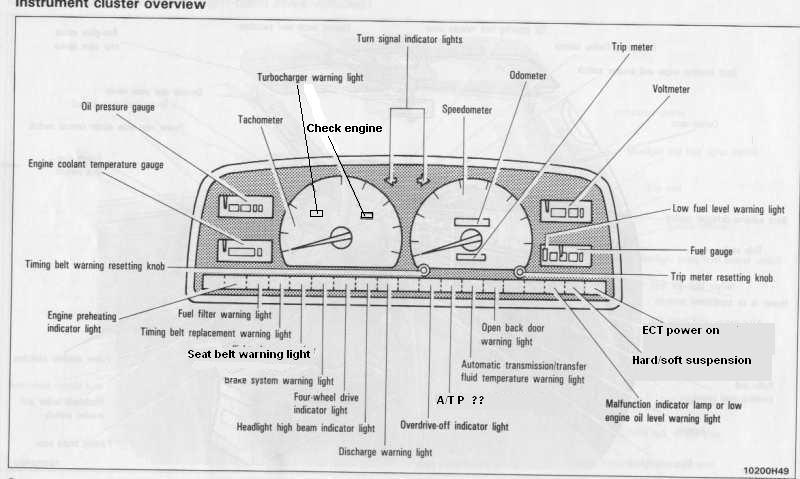

        Hi,
        The Surf dash is slightly different. I have modified the picture with the warning lights on my dash.
        The only one that i'm not sure of is the A/T P light. it has never lit up??
        Ian

          Hi,
          Thanks for update. Took Marky's diagram and sat in car this afternoon. Neighbours think I'm mad since I got the Surf. Spending a lot of time on the drive. Anyway, went through diagram and ticked them off one-by-one. Nearly got a full set now I've fixed the parking brake switch. Only differences weres a seatbelt light where Marky's diagram showed a low headlight cleaner washer fluid level light, don't get a hazard warning indication (just get both turn signal indicator lights flashing) and Suspension setting indicator where Marky had Driving Pattern Indicator (assumed this was same ?).
          Have an engine warning light on RHS of tachometer face but nothing on LHS. This lights up red on ignition but then goes out once started and during driving. No sign of a turbo light still. Also, no dipped beam indication anywhere. What's ECT on far RHS ?
          Got an A/T P lit up (although have no idea what it is either).

            electronic control transmission (i think,( someone will correct me)) its the little button on the centre console that keeps you in a lower gear for longer when a bit extra power is needed, like when towing or going up steep hills. Hope thats a help.
                    Does anyone know what this 'A/T P' light is for??
                    I was beginning to assume it should light up when the transmission is in park but it has never lit up for me!
                    If so, as crashyb's is a MANUAL, why is his lit ????????
                    Ian
                    One day my paranoia will go away!
                      My mistake (well actually it was my wife who ticked the picture yesterday but daren't tell her). Have just been outside and switched on ignition again. I've got "A/T oil temp" lit up (first light left of "Open back door warning light").
                      A/T is suspiciously like an acronym for Automatic Transmission but its definately a manual !.
