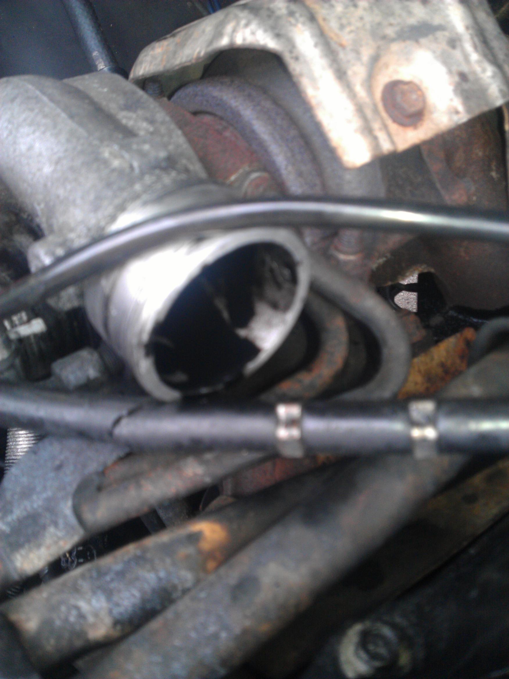

Hello all, I am having trouble diagnosing my recent issue with my Surf.
Was driving down the highway yesterday when I started loosing power and was trying to accelerate but the truck was slowing down. I thought maybe it was fuel related but once I got it home and tested for fuel blockages found that there were none. Checked at the primer pump, the injection pump and at the injectors by cracking each while the truck ran.
It runs really rough and smokes like crazy. I have recently replaced the injection pump and suspected that timing could be an issue so I pulled the timing cover to inspect. All timing marks line up correctly and everything looks good there.
I'm not sure what to do next.
The truck has been using oil for the past while and usually has lots in the intake.
I think turbo seals could be gone but would this cause that much smoke an loss of power? I guess compression test could be an idea of something to try to make sure everything is ok inside.
If you guys can think of anything else please let me know and I'll try it.
Thanks in advance.
Hagen
