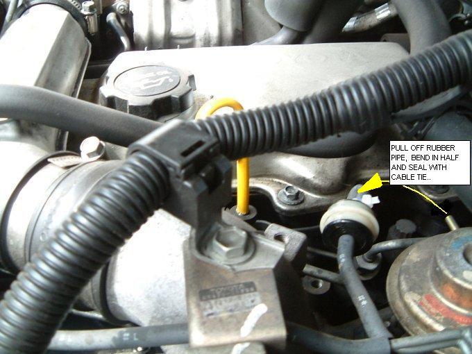

I know the topic of black smoke has been done to death on here, but my question relates to the EGR system on these vehicles. I have searched on here extensively for the EGR mod as everyone suggests, and short of going down the route of blanking the plates off to the piping, I want to first just try the cable tie option on the vac pipe. I cant find anywhere on here a photo of the exact pipe which needs to be blocked/tied/crimped off. Could someone please give a newbie Surf owner a pointer to a photo please or post a quick one up so I can try this mod.
