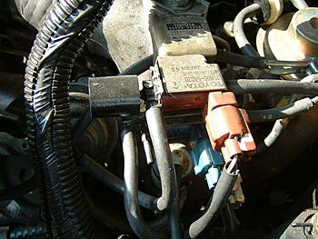

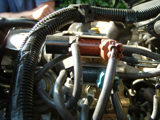

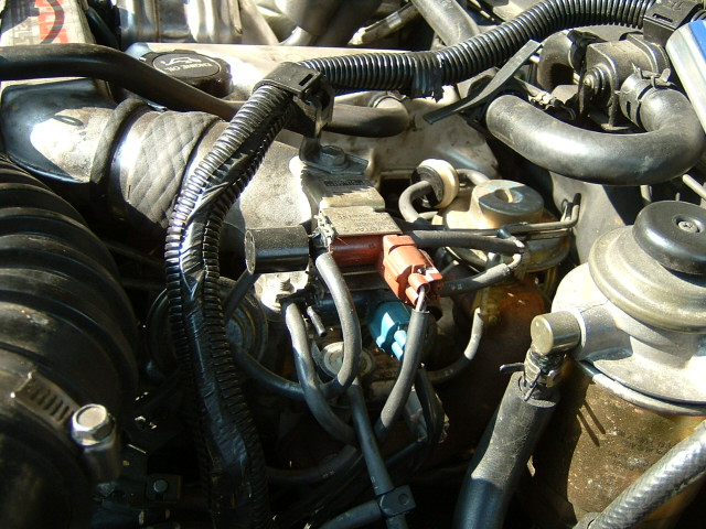

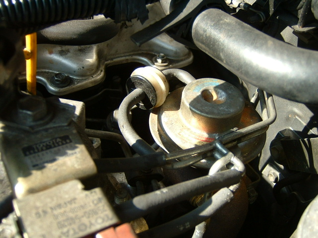

          I have had a look at Barnaby's surf and sorted one of the water leaks, but he has a 2LT and I have a LTE, so could you look at these pictures and see if you can find a pipe that is located on the wrong connector.
          I removed the Turbo pressure sensor pipe because I'm sure that's on the wrong one, but need to sort out where all the others go.
            Sorry they did not come out very well, so could someone else post some pic's of their own surf to compare.

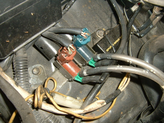

                    Heres a few I have
                    My 4x4
                    My choice
                    Back off
                      A couple more, if you need any others let me know I will take some more tonight, already had these ones.

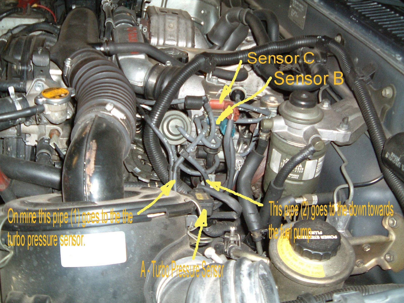

                        This is how mine is set up. Is this correct, should pipe 1 be attached to the Turbo sensor?
                        What are the sensors B & C?
                        Is it worth replacing these?
                        Also could it also be a faulty oxygen sensor causing the low power, if so where is it and where can i get one?

                          Straight off I can see a problem, see this pic and look at the pipes I have high lighted in white and blue on my engine. Then look at yours I think you will find that where the blue high lighted pipe is on mine you haven't even got a pipe there.

                            They were correct, but when Andy took the photos we had swapped them round.
                            Do you Know what those top two sensors are for. I might try taking the pipes of and checking for blocks.
                              Not 100% sure but they open and close via electrics to shut off/open the vacuum to certain things. From memory I think one of them is connected via a T piece to the turbo sensor and something else and should open and close as required.
