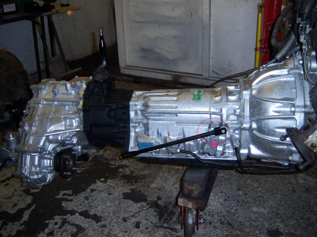

                Hi again, didn't undo the pipe because didn't bring my tools. Looked everywhere for the 9 wire multi-plug but couldnt find it anywhere on the transmission. Couldn't find the trans ECU either, where exactly are they located?...
                      I circled where the multi-plug goes, in the attached photo Paul....
                        Cheers Vince but i cant enlarge the pic because my laptop contains errors. Really appreciate your time and effort....
                          ah got it, my laptop was lying. When i check the switch and still no gears i will be up to you the gearbox.....Thanks Vince.
