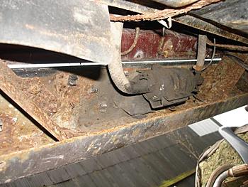

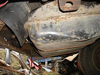

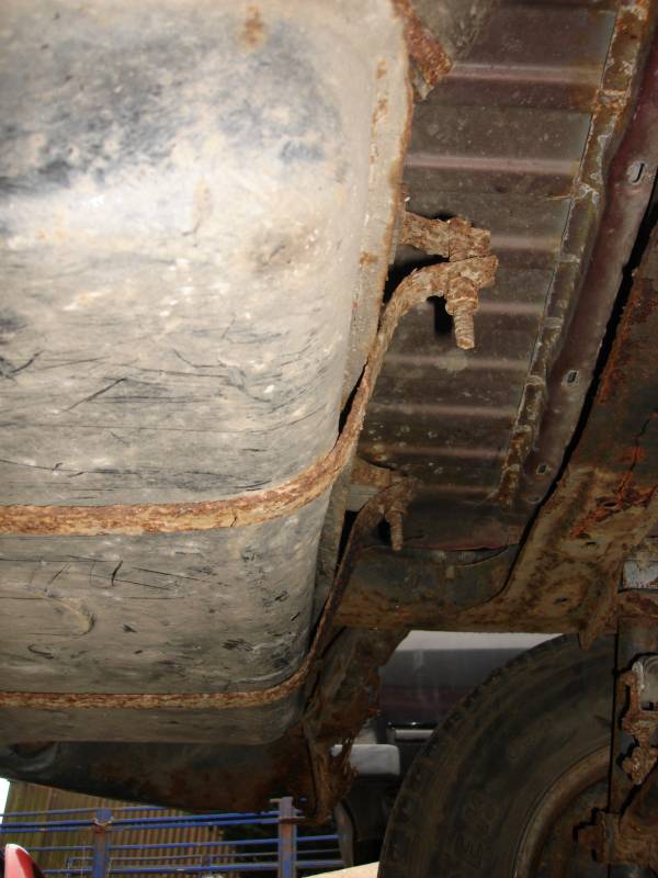

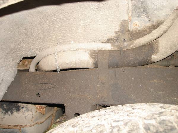

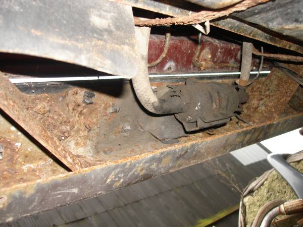

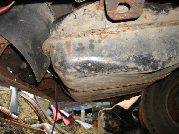

              Pics as promised. (sorry for the delay)
              Think the original tank has been bypassed as the filler goes straight to the aux tank and there's an electric fuel pump as well.
                Is that a fuel pump attached to the back bumper? not sure that's wise..
                it's in me shed, mate.

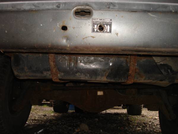

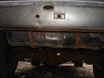

                      Thanks for the pics it will help alot.
