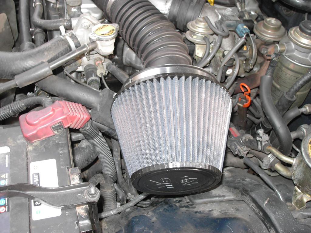

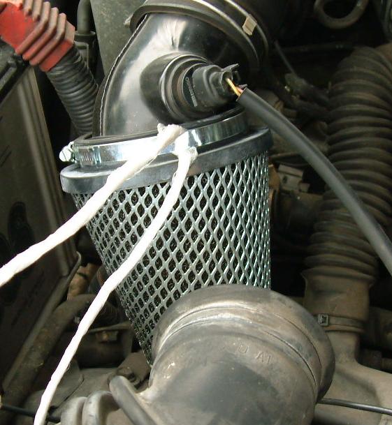

I've been thinking about fitting a K&N filter for some time and have seen a number of references (mainly on the Aus site) to the correct part for a 2LTE being K&N 38-9070. Well all I can say is that their 2LTE's have a different air cleaner to mine - this part is way too tall to go in the air box. Maybe it's something to do with being upside down
After a bit of research I have found a filter that does fit, namely K&N E-2487. This is 140mm tall and has an inside dia of 108mm (and, not so important, an outside dia of 171mm). Most car shops should be able to order them.
