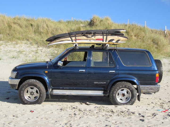

Thanks in advance..gratuitous pic of my lovely surf on a beach in tiree below!
