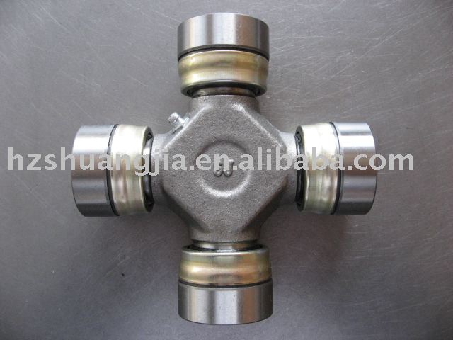

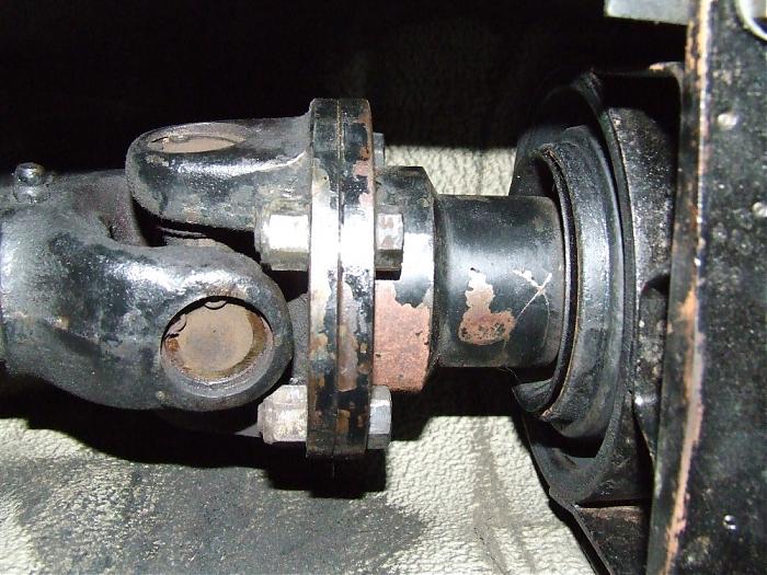

air in the coolant air locks the whole system so instead of the coolant cooling the engine its trying to cool the air stuck in it thus it cant get warm you need to burp the system to get the air out you should get hot air then (think of it another way imagine having a air bubble stuck in artery or vein). if you have checked the rad and bleed the air out have a look at the rear heater under the arm rest thing that could be blosked also and give the same problem all it is is a mini radiatror same as the front rad. a uj (universal joint) is the joints at the end of your props so it can rotate with out seizing the bit in question is the + bit holding the props together. the + sits inbetween the knuckles and holds the prop together.
