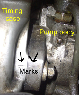

    Pump marks lined up??
      ah good point mate to be honest i couldnt c any marks and when i removed the old one they looked as if they were in the same position ill go have a look now thanx mate

        hi mate just checked it and it was only slightly out but i timed it anyway and still the same noise

              do a 180 on the timing fuel pulley pump, happened to me
