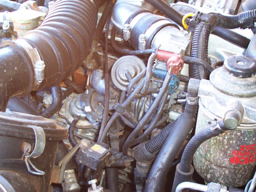

                      doubt its the injectors mate if it was that it would be lumpy all the time and sound like a tractor. have ya checked all your vac lines that none of them have split or popped off?

                          the vac lines mate are the thin rubber hoses in your engine bay you should have a few on the passenger side of the engine and a few by the dvr side wing in the engine bay. have a look at the pics mate, the proper pic is of the passenger side of the engine.
