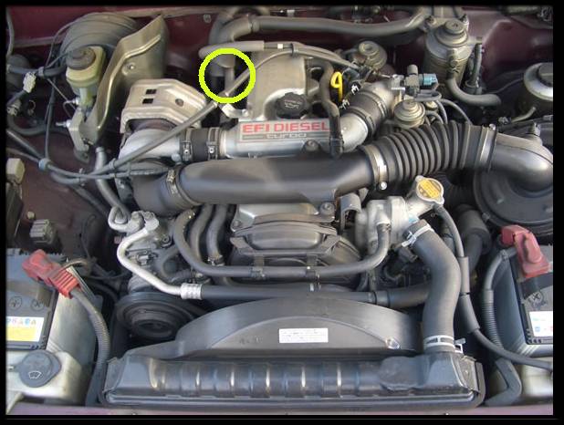

              When I did mine I unplugged the 2 pipes that attatch to the metal pipes that run down the left hand side of the rocker cover. (at the back near the turbo). Follow the 2 pipes from the bulkhead and you'll see.
                  Thanks for the pic Wish, im assuming you mean follow the two pipes that have some sort of foam warpped round them, That smaller pipe behind the longer one that goes off to the right is the one i just couldnt get hot, the long pipe i managed to ge4t pretty dam hot.
                  Ill have a look at the pipes further down as per your pic but im hoping theyll have jubilee clips on them NOT those dam squeeze together clips.

                      Where I circled the pipes from the bulkhead join 2 metal pipes that run under the 'efi' pipe. Disconnect there. Replace the crappy clips with decent quality hose clamps (I only use genuine Jubilee brand)
                        Yup, got them, but where is all this extra water from the hose going to exit ?
                        Surf K Reg LN130 2.4 AUTO
                          You on a wind up ? One of the hoses goes into the matrix, one is coming from. Disconnect them both from the metal pipes. Put hose in one of the pipes, hopefully if its not all blocked see mucky water exit other pipe all over your engine bay and drive. Leave hose running for ten minutes or so. Then remove hose and stick it up the other pipe to reverse flush. Repeat until water runs clear. Reconnect pipes and top up water.

                              As you stand in front of the engine the pipes are to the right of the engine. 2 thin pipes that go from beneath the thermostat housing to the the passenger side wing. They attach to 2 metal pipes. If you get under the truck you can trace them from the centre console.
