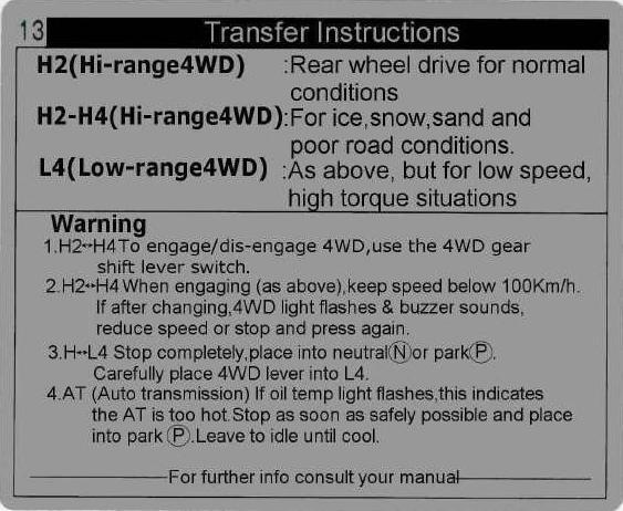

    -the guide on the sunvisor is written in japanese and i would sort of like it in english? i think it is the 4x4 instructions.

        one card is for the 4wd you may have another one for the grease points
            Like the one posted on the front of the forum
