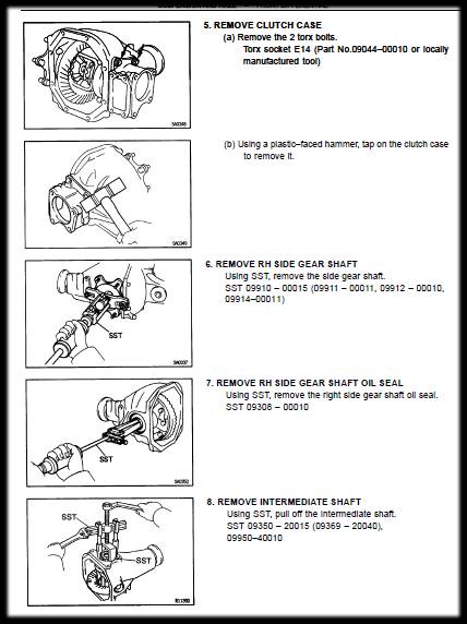

    Hi Guys,
    Just been looking at Bushy's ADD post, ( brilliant mate )
    Now then, I have a leaking O/S inner driveshaft seal, got
    the seal from R/T.
    Is it a case of remove the driveshaft, (done that before)
    apply outward pressure to the tri cup and hit it wiv a big
    hammer to release the snap ring? I have seen a diagram of
    the ADD before but I can't find it now, so any info would
    be helpfull, TIA.

      Looks like they use a slide hammer bolted to the flange.
