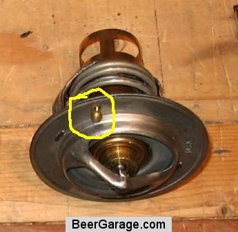

      Did you make sure the jiggle valve in the 'stat was at the top when you fited it?
