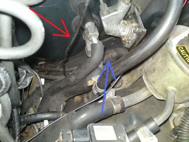

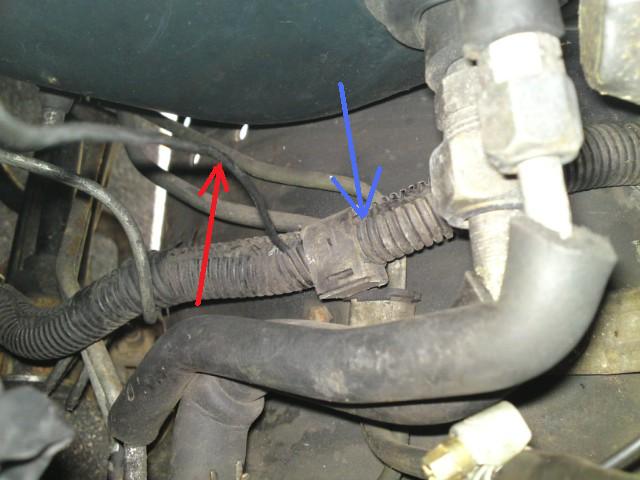

              ok, heres a picture of the stray wire (Red arrow) and the loom it goes into (blue arrow). Any ideas where its meant to go or is it just another random wire that the previous owner decided to play with. This seems to be the biggest problem with my truck, its had so many random hacks done to it, especially the wiring, that I dont know whats right and whats wrong!
              In the third picture, is this the hose that always slips off and gives people turbo problems?If it is, as you can see its in place, so i'm stumped as to why my truck is gutless!
              Cheers for all the help!
              And for those of you with a keen eye you will spot my incorrect fuel filter in the last picture...another thing I did not know was incorrect when I bought the truck, but for some reason the previous owner took the bracket off, fabricated a new one out of 2 bits of box section, and stuck a tiny little filter on!Bizarre!!

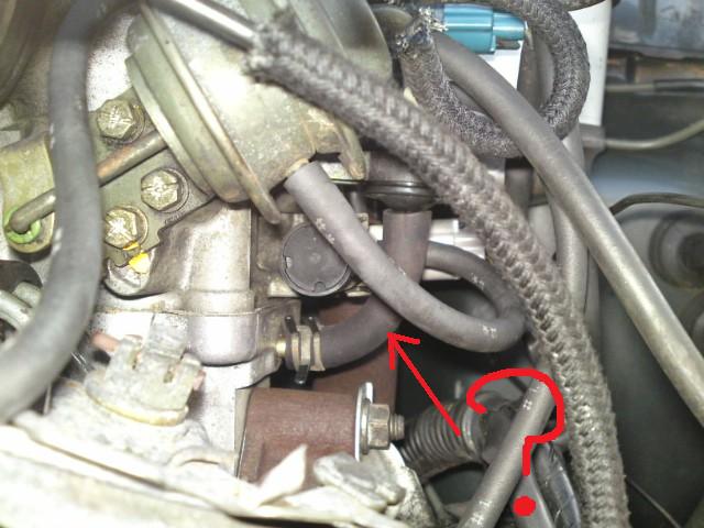

                At the bottom of the first pic you will see the turbo pressure sensor. Is the hose connected to the underside of this? The one from manifold (in third pic) goes to a small filter then a smaller hose to the sensor. Not sure about the wire but will have a look at mine sometime.

                  Just had a look, and yes, the pipe is attached to the turbo sensor..... This is a very frustrating problem. And thanks storm force, but I cant find a plug on the pipe from the airfilter?Am I being thick??(you dont have to answer that!)
