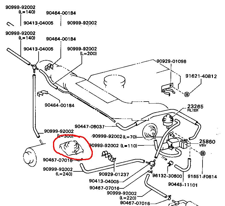

        I have a 2.4L Turbo EFI and funny that the diagram of vacuum is not same like mine, check this diagram where i marked with red i dont seem to have this in my engine.Plz reply me with explanation.
        bye cheers.
