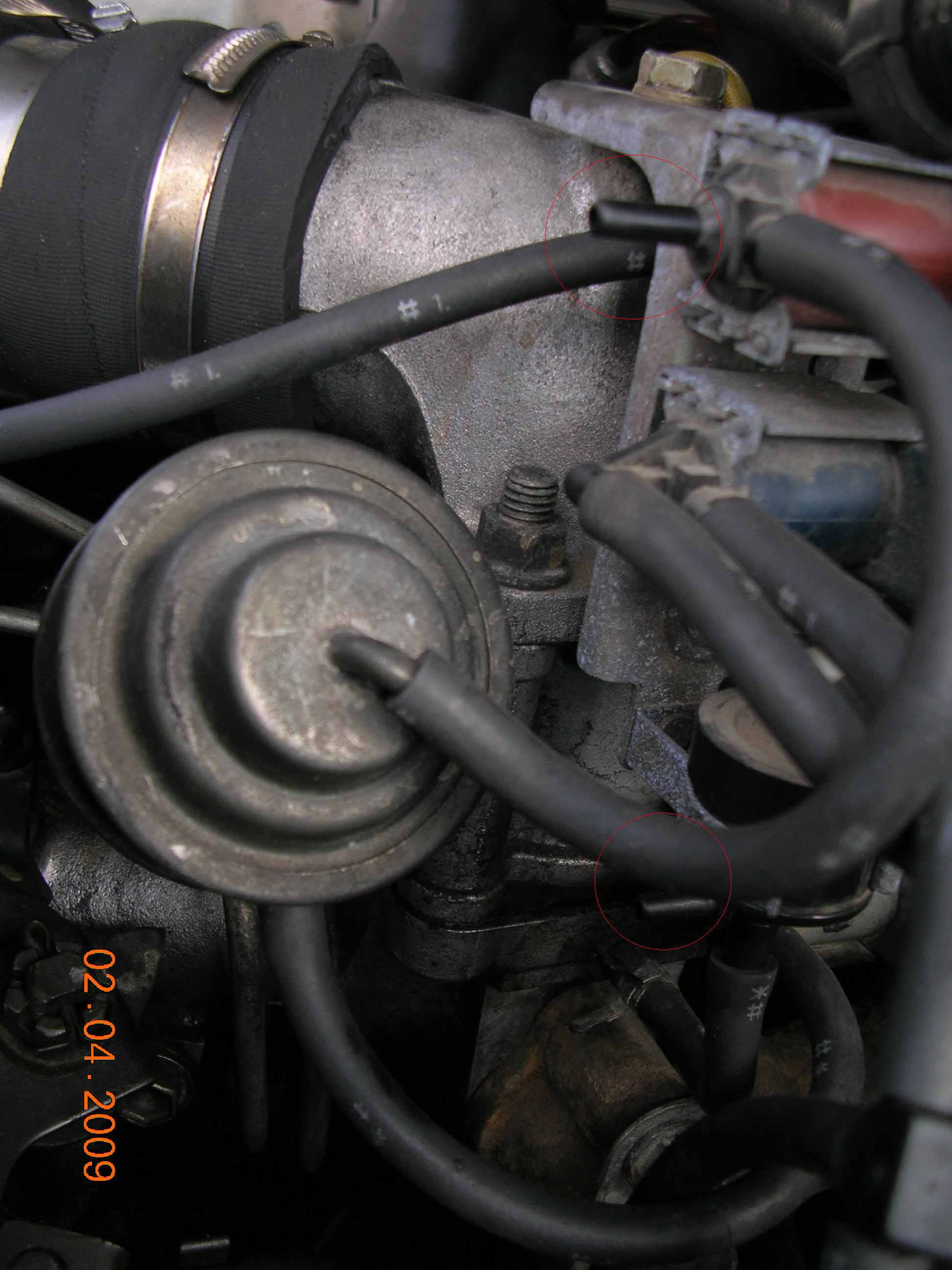

    Have an '89 Surf ln130 2lt (mechanical pump) and have just recently had the IP rebuilt. Was having severe problems with idle and power. Now have the power back but the idle is still up and down, and occasionally stalls at lights. Noticed a couple of vacuum lines missing??? on the vacuum switches by the fuel filter assembly.
    Anyone have some pics of the area to give me a hand?

      Looks as though the two I have with no hoses actually need caps on them.

        I can see what you need now that you mention caps. Do not cap. There should be a cylindrical filter on each of the VSVs.

          those valves are shut down valves, they choke the motor when you turn off the key, so that it doesn't run out of fuel from the pump and need rebleeding when restarting, it keep deisel at the injectors.
          its either back to front, and trying to stop the motor, therefore its struggling to start and idle.
          Either dissconnect it completely (make sure the small butterfly valve on the intake stays open), its not that bad without it, just shuts down lumpier, and takes slightly longer to start, or get it working properly
          If the vacuum lines are messed up, check your EGR is working proplery as well, it might be on all the time
          Then i'd look at glow plugs or a airleak into the fuel system.

            As far as I can see the two hoses to the vacuum diaphragm are in the correct place. Your problems could be elsewhere where they are connected wrongly.
