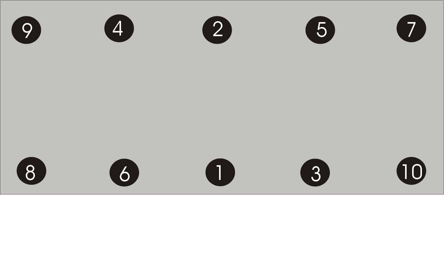

    These are the torque settings just can't find the sequence at the mo
    2.4 2LT/E
    1st stage 58ft/lb 78nm
    2nd stage 90 degree turn
    3rd stage 90 degree turn.
      2.4 2LT/E
      i know ive only gone to ten but you get the idea
      [size=5][/size]
        right ok this is for the 2L engine, will need to check it against the manual but I am sure its the right one
          as long as you start in the middle and work your way to the outside crossways thats ok, but remember to follow the sequence 3 times, tighten all bolts to stage 1, then all to stage 2 and finally all to stage 3
