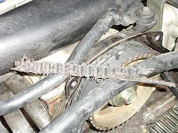

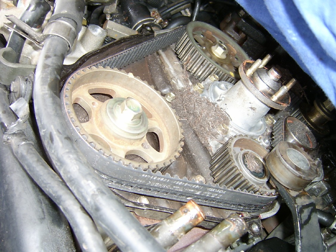

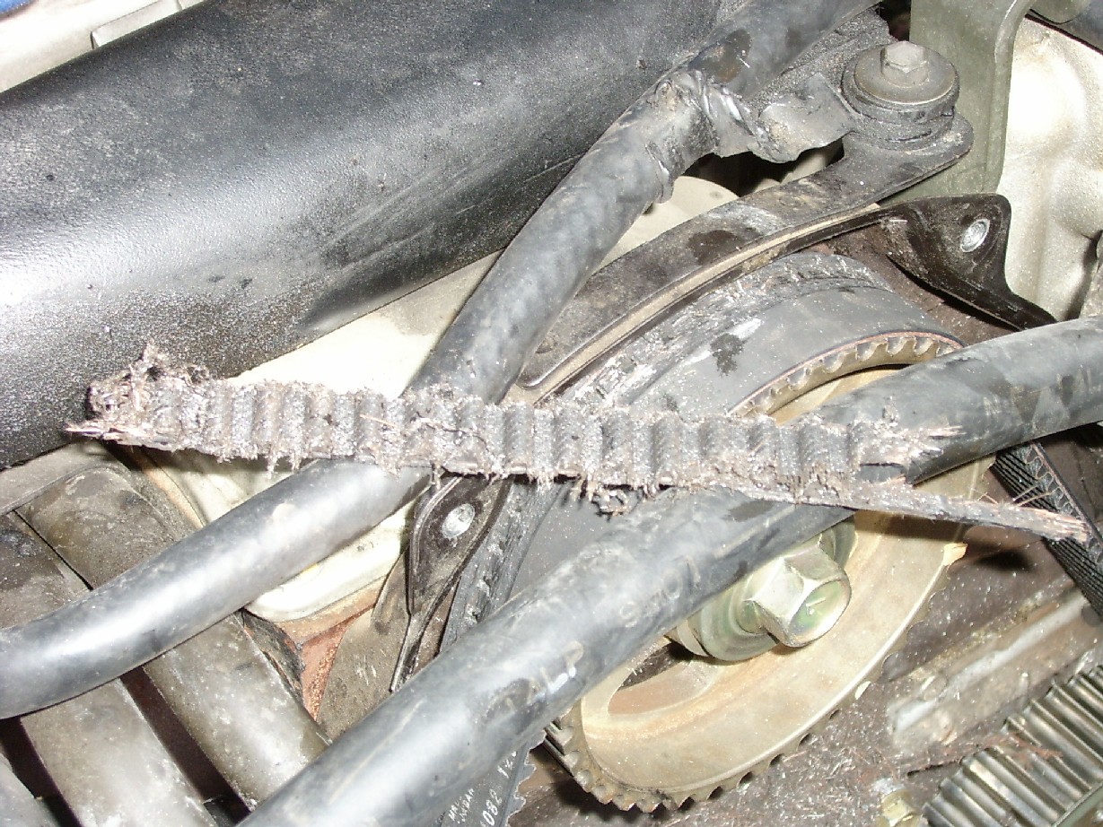

Right then, i got round to stripping the engine down to the cam belt tonight and found the problem:-

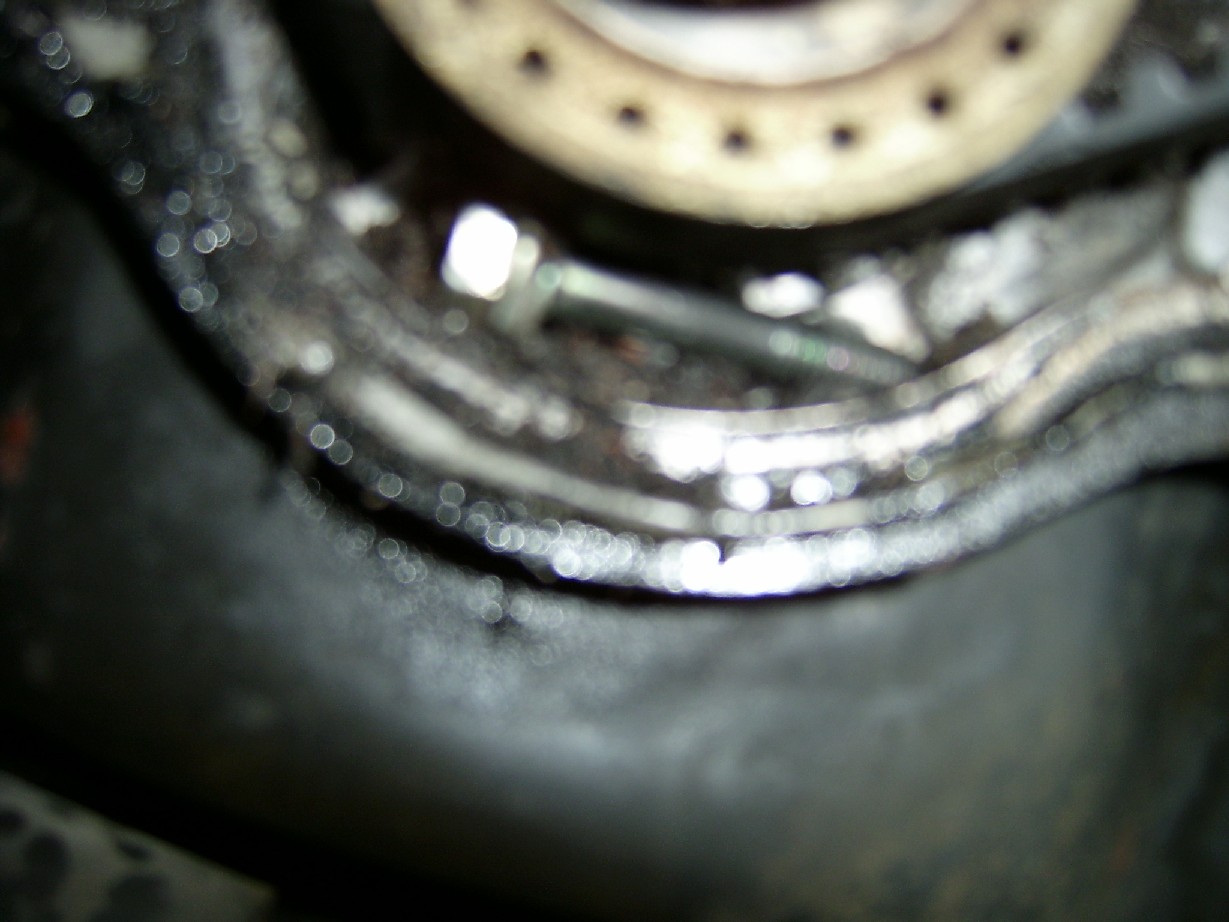

The cam belt is absolutely f@ck#d(pictures to follow) i reckon it has done about 500mls since it was changed by my local toyota main dealer(who are known for being very good). The cambelt has been rubbing on something which i will investigate tommorow, which means that two thirds(width) if the belt is thread bare with holes in it and virtually paper thin!
So someone is in for a major bollocking when i got round there at 8am on monday morning
. I have got to say that i am seriously ****ed off, but glad i took the time to investigate myself now i will let them sort it at their cost.
I have a funny feeling that if i had taken it in without investigation they would have screwed me for the cost of repairs and denied all knowledge of the cam belt being the problem, that could of course be me being cynical!

Well just to let you know the work has all been done FOC and they gave me a courtesy car(crappy little corrola) but the main thing is they have sorted it but they werent willing to give me a refund despite the amount of hassle they were give, instead they gave me a £60 voucher which i can use against parts/mot/service etc and has no time limit.
