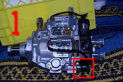

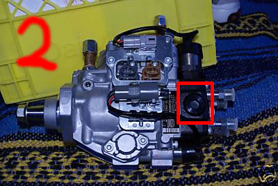

Can anyone tell me if either of these is the timer control valve..? Toyota just seem like they're not really interested.... well that is unless i want to book it in and pay £70 for them to drink coffee!!!!!!

I checked my book and it seems that your first pic 1 is the timing control valve.
