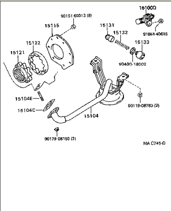

    Hi Steve, you will need to drop the sump to remove the front casing as the oil pick up pipe is attatched to it, sorry! hope this helps a bit.
    Cheers, Steve.
      Diagram below shows where the oil pickup is connected to the housing and inside the sump.

        thanks guys, apparently i need to remove front diff to get sump off,is this a hard job anam i right in thinking i need to disconnect driveshafts , undo engine mounts and then raise engine with jack,,never really worked on a car before so any advice is very welcome.........when i've eventually got sump off are there any other jobs i can be doing. i don't think my surf has had much tlc in the past...i'd like to know how to thourouly flush engine. oil was changed when i got it and 2 months later it was like tar. thanks again for any help
