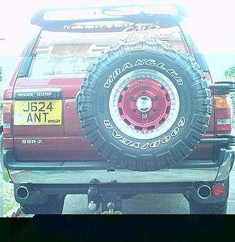

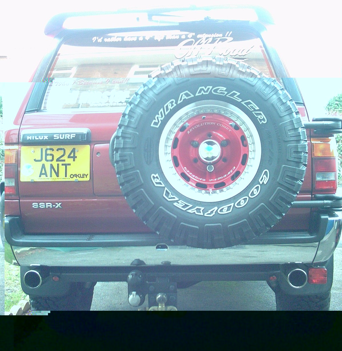

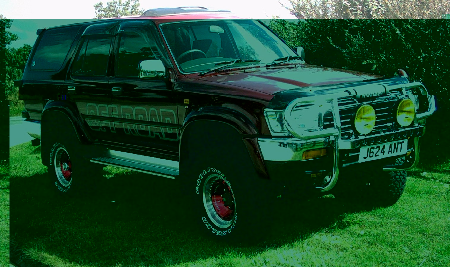

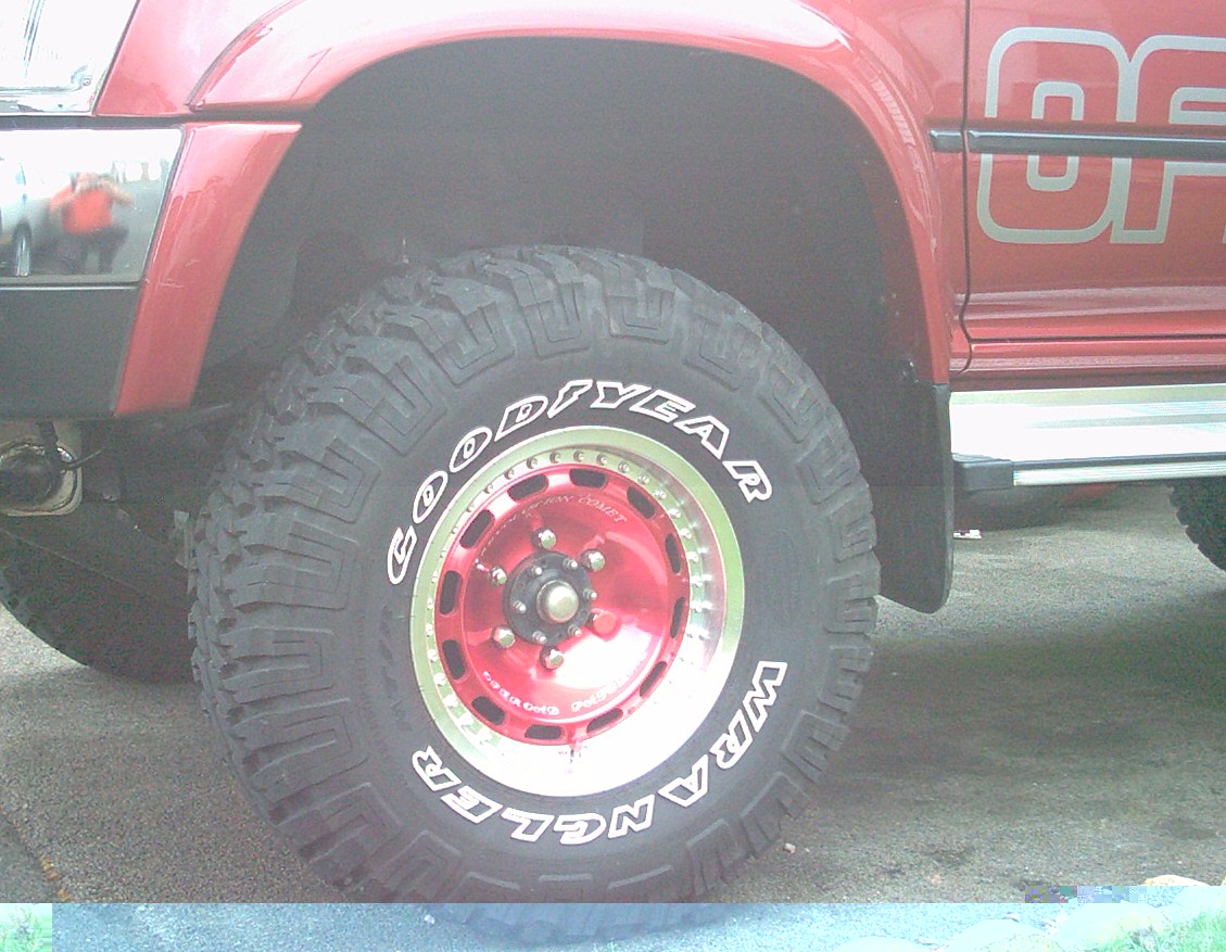

    Lovely truck what size are the rims n tyres and what is the lift made up of????
      The Tyres are 32.11.5 x15 The Rims are called Revolution Comet 15".
      The Suspension is a 4" Trailmaster System from the U.S. The rear being very easy to fit just Springs Shockers (Trailmaster) a bracket for the load / brake adjuster and a couple Spacers.
      The Front is 2 x Shockers and all sorts of drop down brackets spacers and a Crossmember that lowers the Diff / Axle but has the effect of making the overall Suspension 4" higher very difficult to fit and took a total of approx 25 hours to fit !!!!

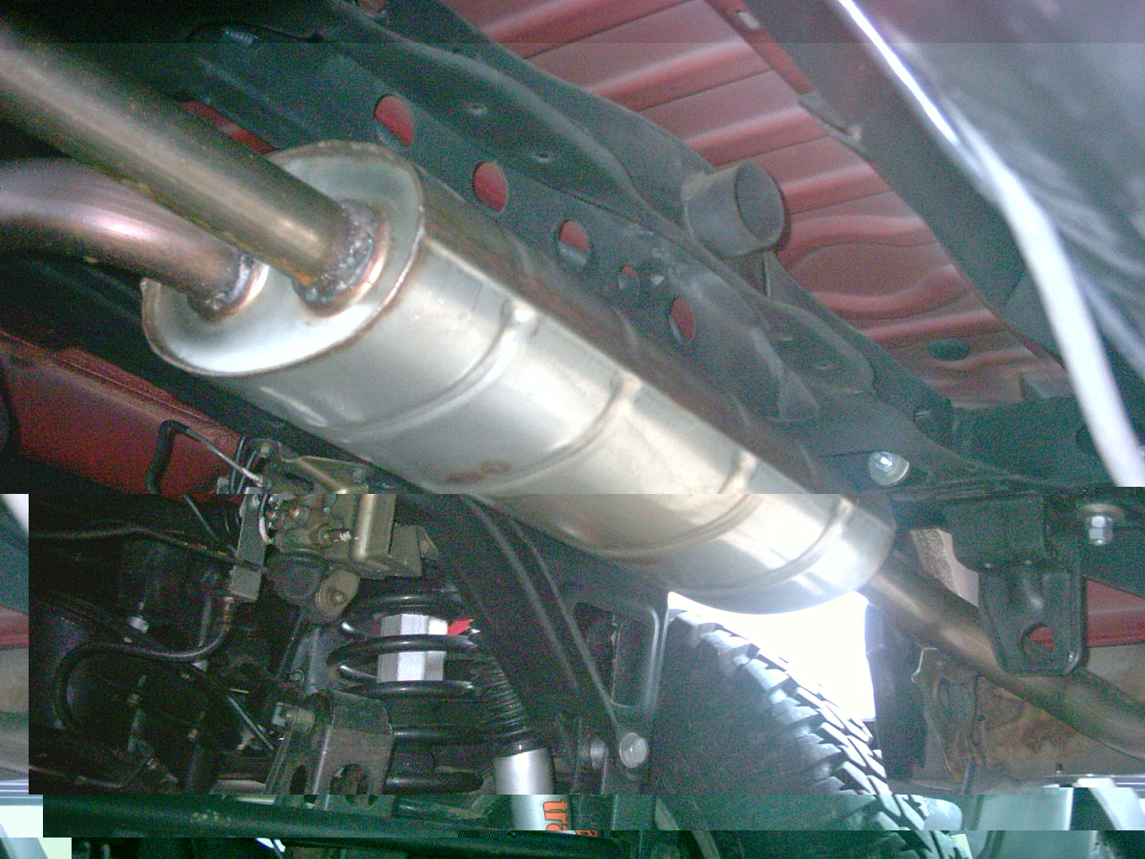

              Yes I noticed that a few had managed to meet up over in Congleton and I was really looking forward to meeting up with other Owners / Members but mid week is really difficult for me being a long distace Trucker and I only get about 12 hours notice of where I am going the next day and on that Wednesday Evening I did not finish until about 8.00pm and was starting again the next morning at 5.00am !!!So hope to meet up maybe on a Friday ,Sat or Sunday soon. Have a quick look at photos I have attached of Exhaust .
