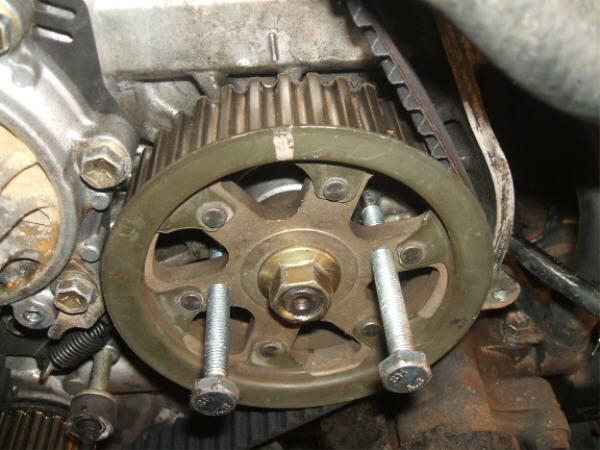

I noticed that the FIP gear has two threaded holes it it, I screwed a long M8 bolt into one of the holes, turned the gear until the timing marks were aligned and then very gently tightened the bolt until it just nipped up enough to hold the gear in place. I then installed the belt in a clockwise direction starting at the cam gear and working round the gears, then released the tensioner and let it take up the slack, removed my "locking" bolt from the pump gear, turned the engine over by hand two full revolutions, rechecked the timing marks, reset the tensioner and lo and behold job done without any need to try to calculate how far back to set the cam and crank gears.
