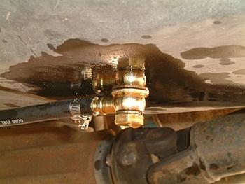

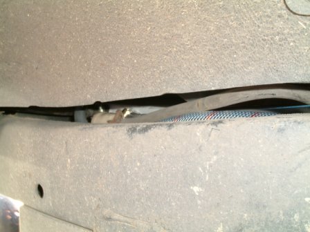

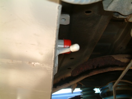

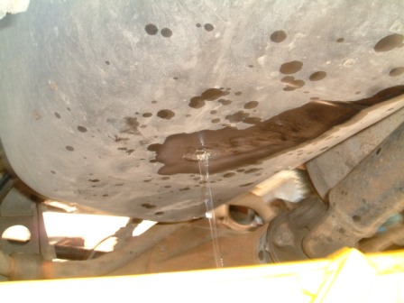

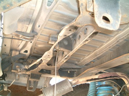

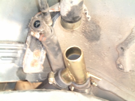

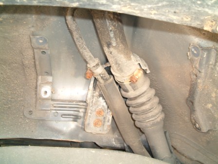

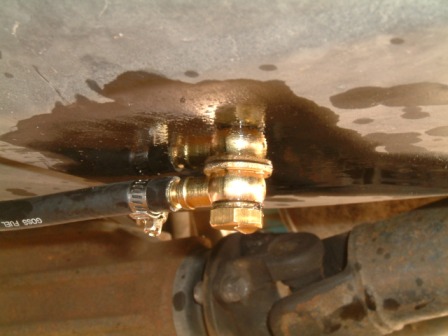

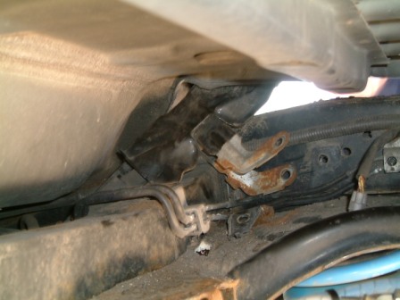

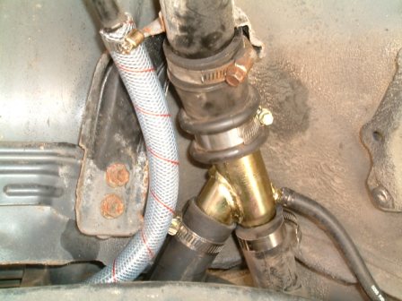

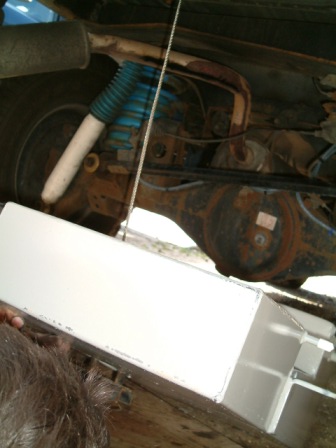

      the fuel tanks have got a drain plug on them (as far as i know) is yours lose, or missing?

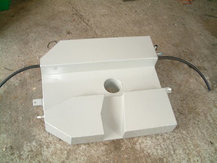

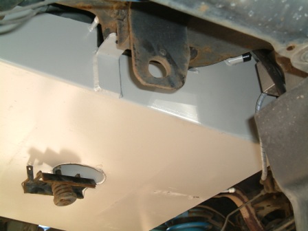

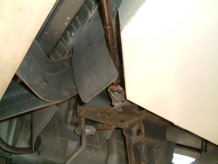

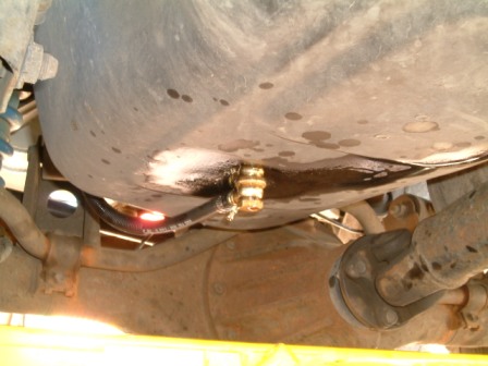

        There is an overflow below where you put the nozzle in, just behind the fuel flap, which will drip on the tyre from inside the wheel arch... there should be a photo archive here of my second tank which might show the various connectors down to the main tank which might help.
        Can't find the thread, found the images though...
        Last image is without the bash plate... that is what replaces the drain plug... at least on the longranger tank...
