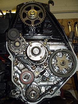

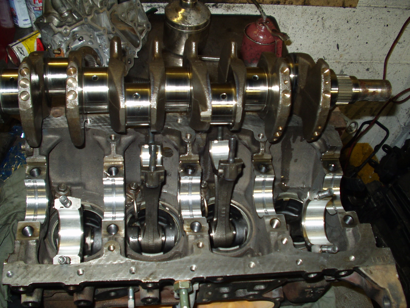

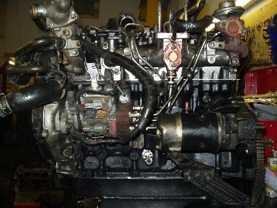

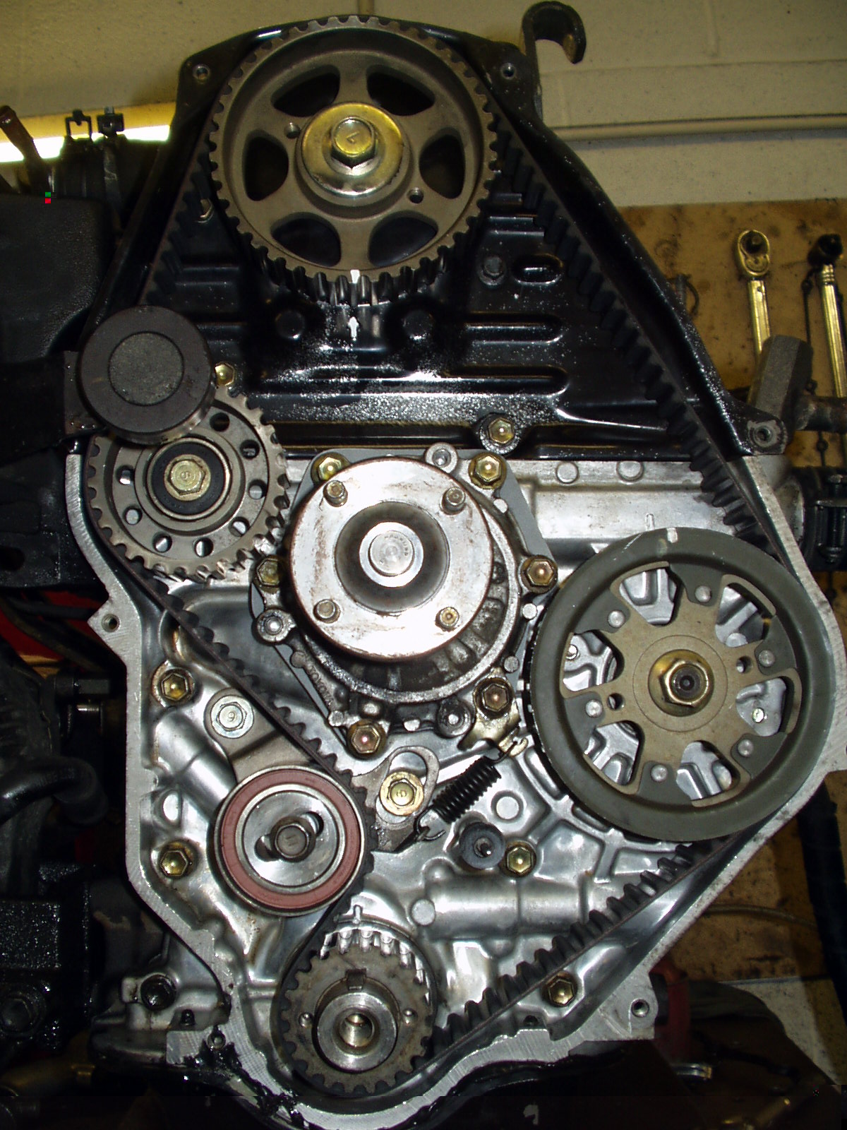

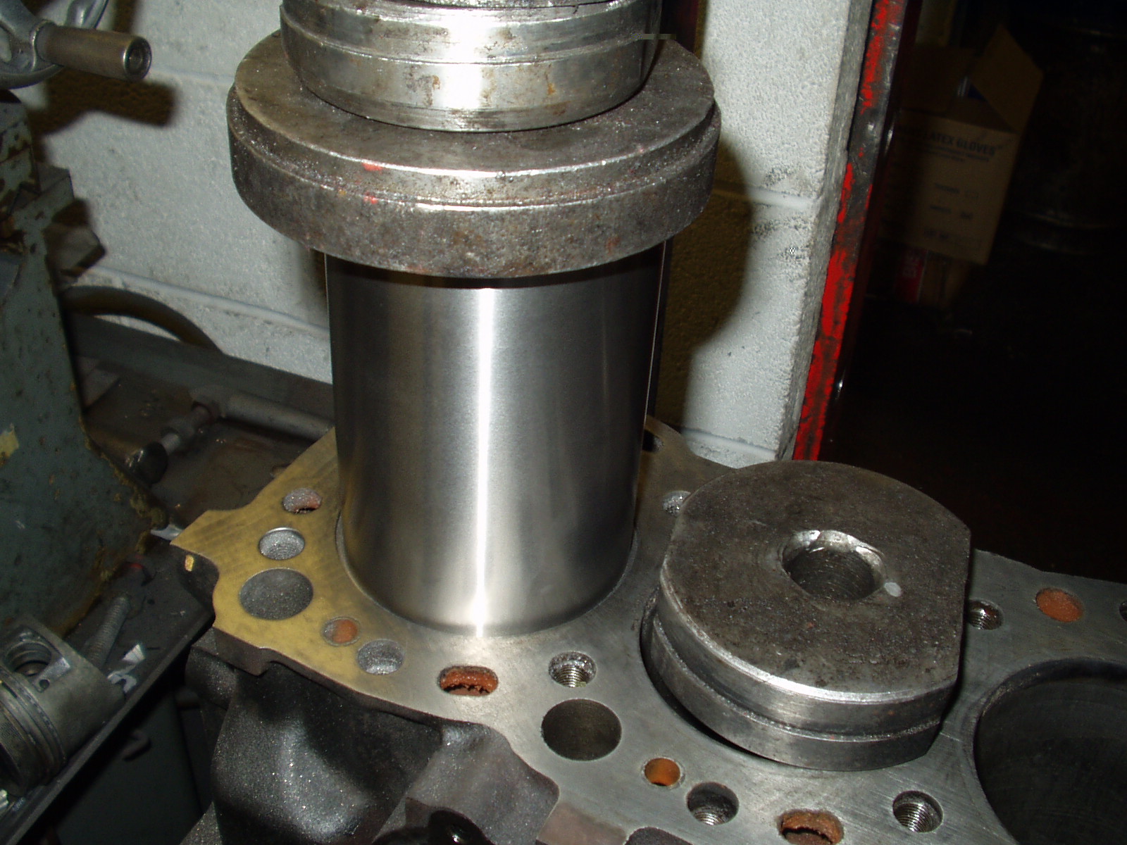

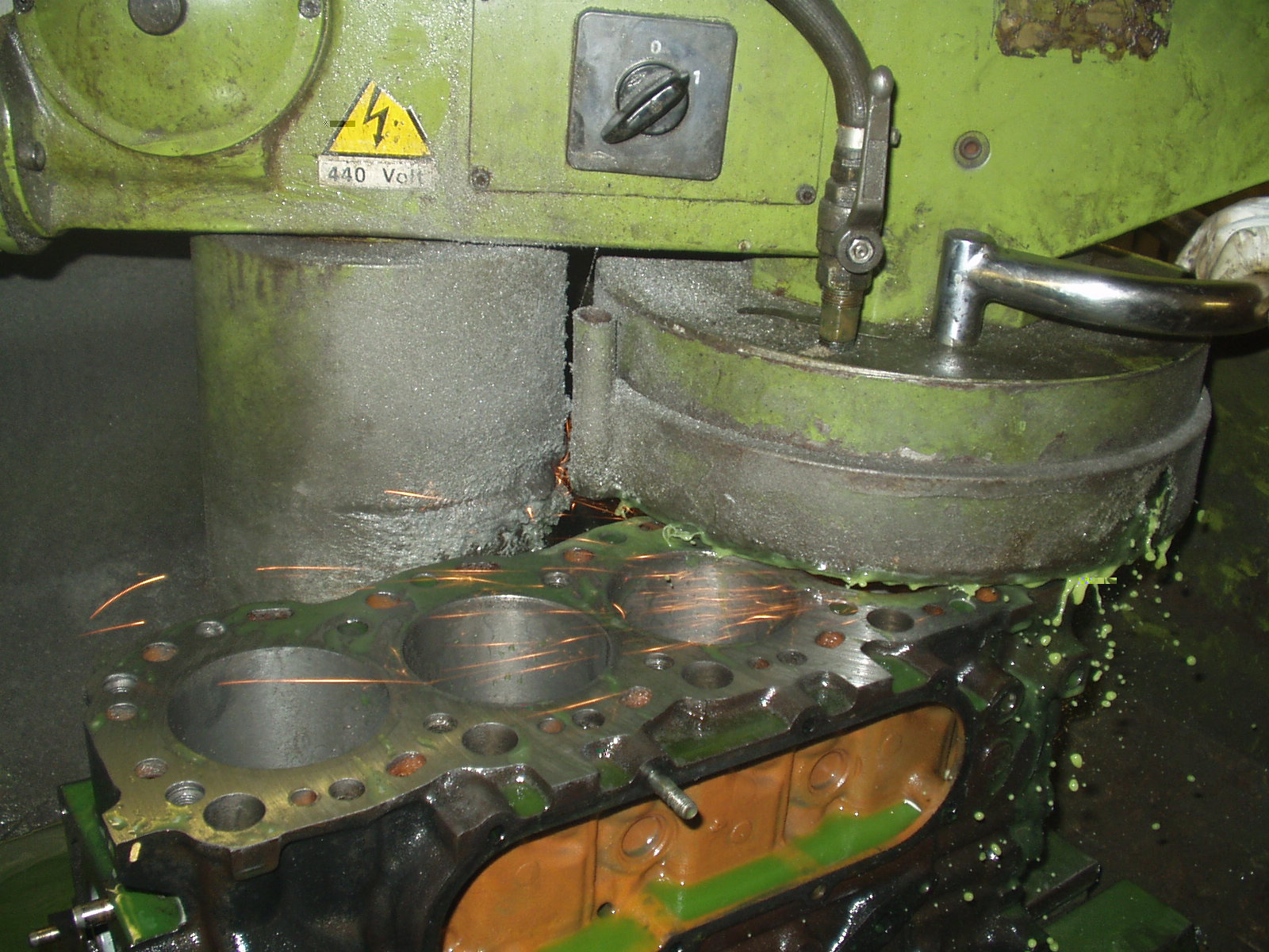

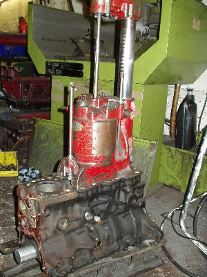

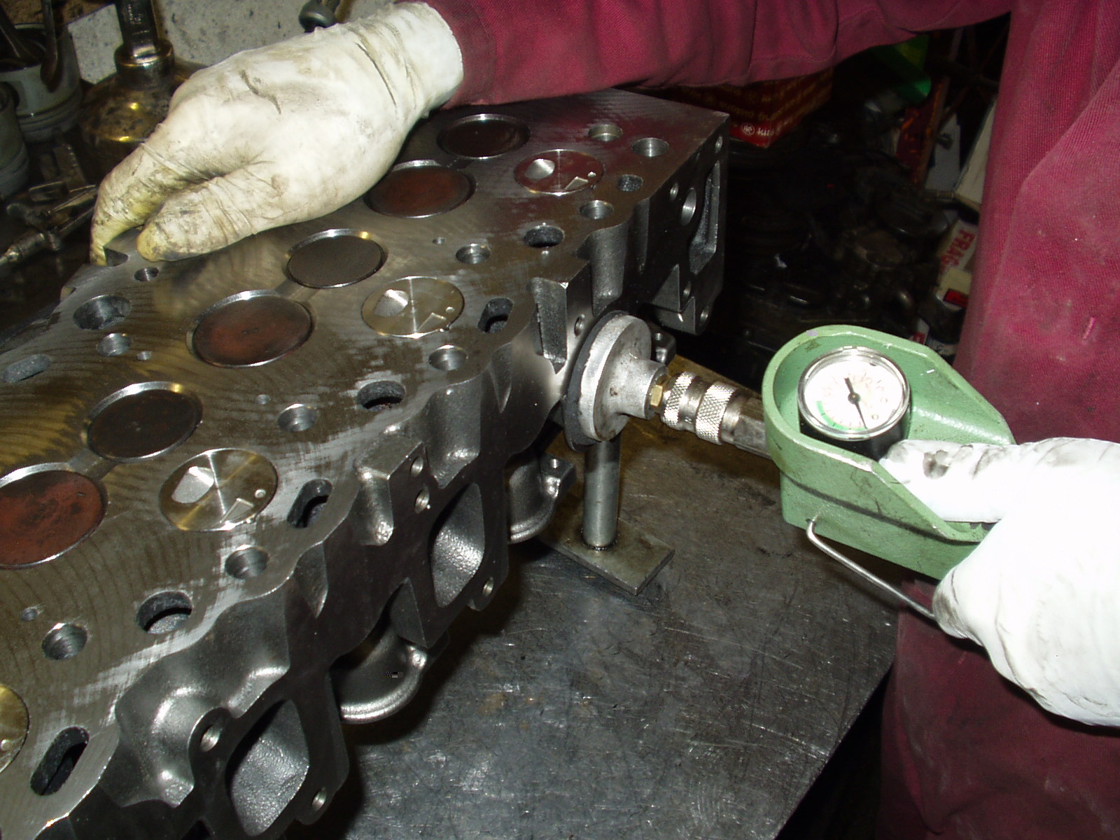

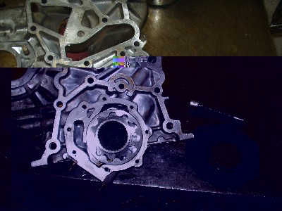

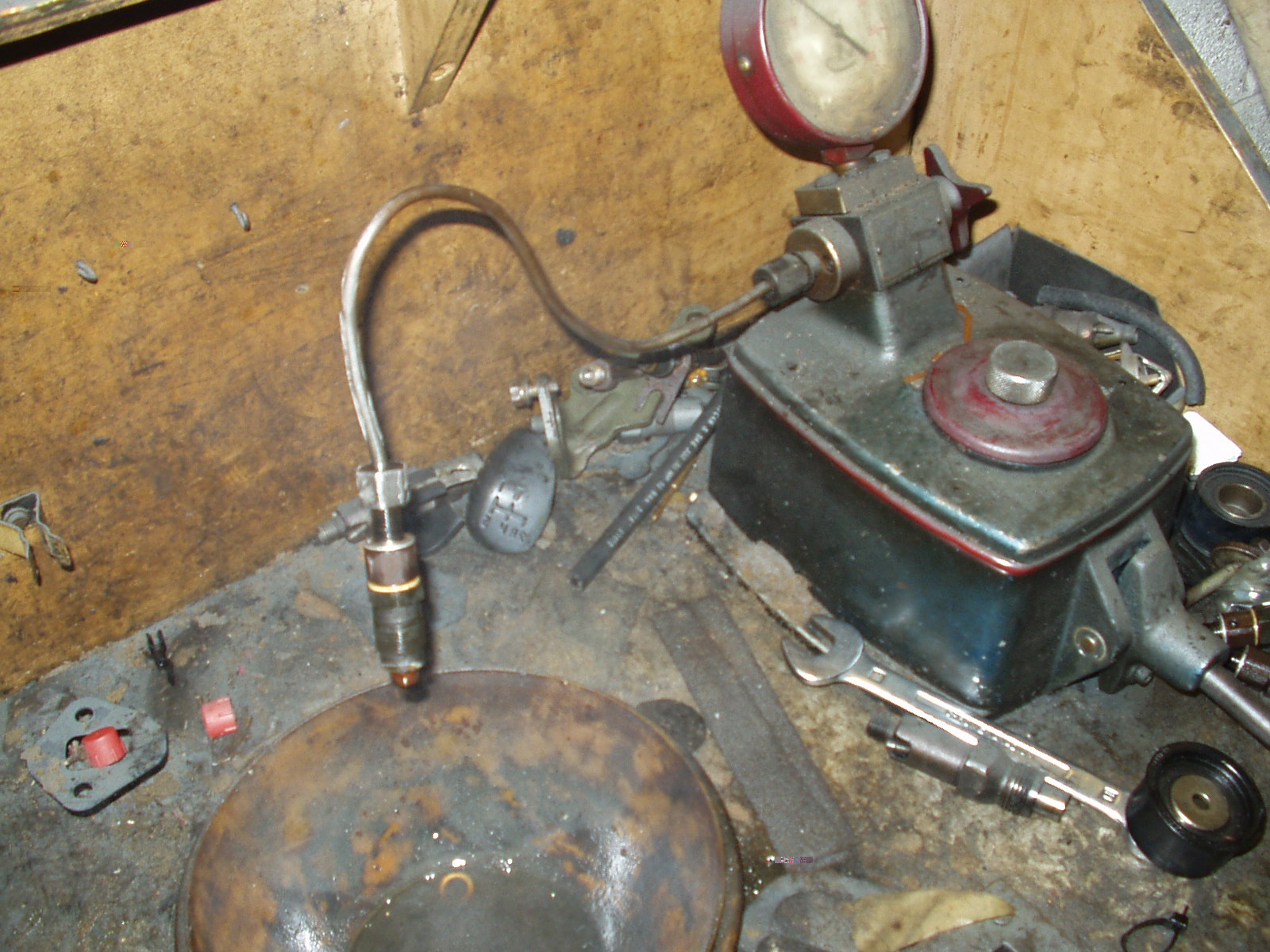

    Here are some pics of my engine at various stages of recent re-build, coutesy of Stevo.

    Nice pics pete General anaesthetic major op stuff.

      That looks like the work of someone who knows what he is doing. Mightily impressed. I just wish that there was someone down here in Bristol that I could trust to work on my Surf, it would be worth getting the job done properly.
      Do I recall the cost as being around £1700? Considering that some places charge £2000+ to fit a new head this was a bargain.
      I hope it goes as well as it looks!

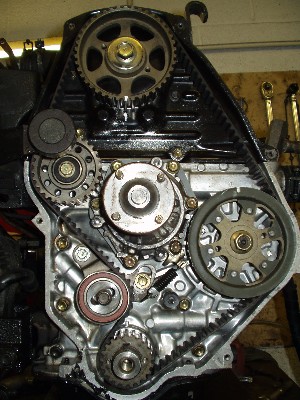

          I believe the pictures are a little slow opening, so here's a smaller set.

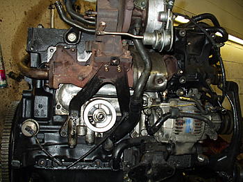

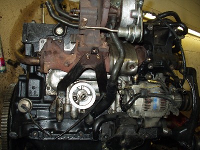

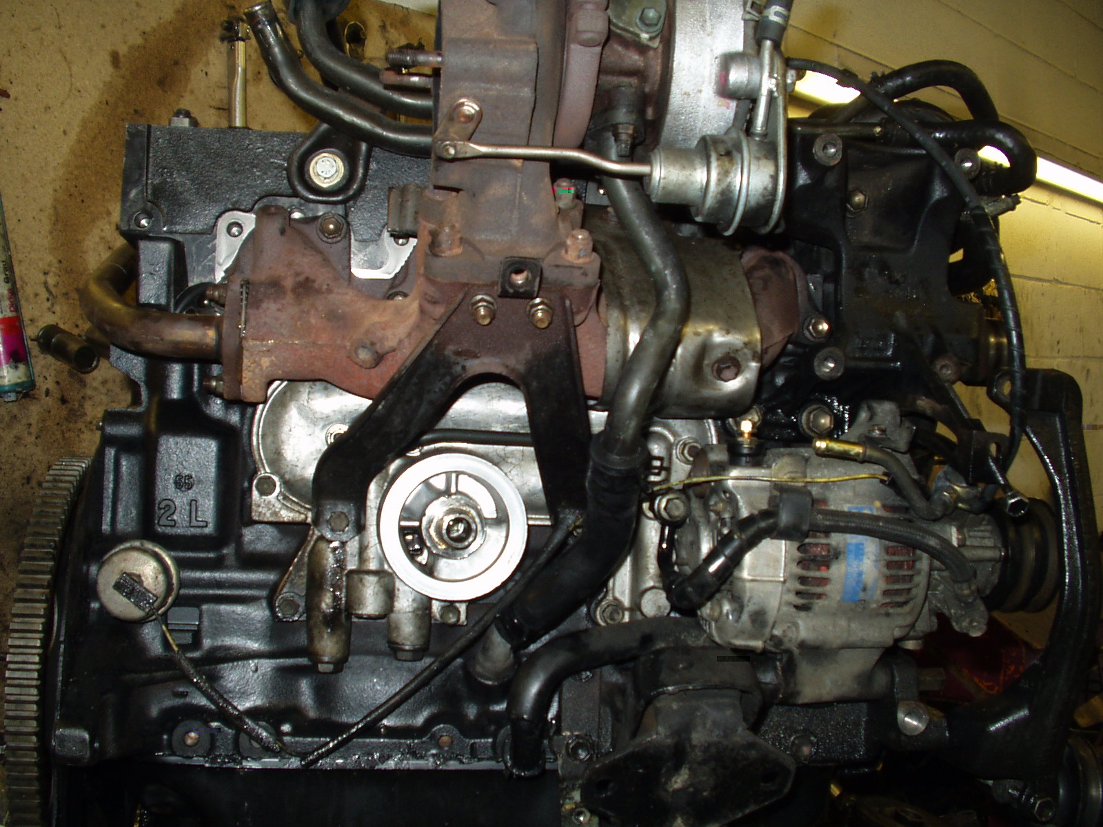

              P1010026.jpg, question
              I'm just in the middle of tearing my engine apart and have a question which hopefully you can help with, in the picture mentioned I can see that you have the oil filter off, behind which is a dirty big (around 36-38mm) nut, built onto the oil filter spigot, do I need to undo this to get the oil filter bracket/cooler off the side of the engine? Mine seems hung up on something and I reckon it's this shaft, answers on a postcard please!!

                bolt
                Pete
                Yes Pete there is a 12mm bolt behind filter thread.
