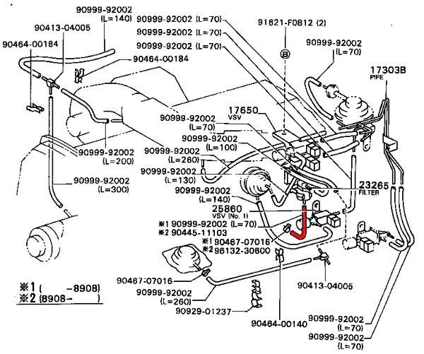

    Can someone post a photo of the vac pipe arrangement as I've lost the trubo & it's recently had a few of theses removed so just want to check they've been put back correctly

    there was a thread recently about the vac pipes, it had pics on it

              The pic that Markey keeps wheelin' out is only good for non-EFI trucks, we need to find one for the EFI motors.

                  There's a few pics here -
                  http://www.toyotasurf.asn.au/techsite/24lteparts.htm
                  Check pic 9. This shows the Turbo Pressure Sensor (bottom centre of pic) and vacuum hoses. This one is often a problem and is easilly disconnected when fiddling around in engine bay.

                          Like nev says, the hose from the intake manifold, up the round filter clipped to the manifold and them off the sender on the air cleaner is normally the one left off.
