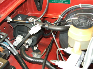

Secondly, my brake fluid is actually full!! It just looked low through the plastic. So why is my brake light not going off then? The little float seemed to be bobbing away quite happily. I did notice that there were no wires coming out of the cap like there is for the clutch fluid - should there be?

Your brake fluid cap should be like this...................
