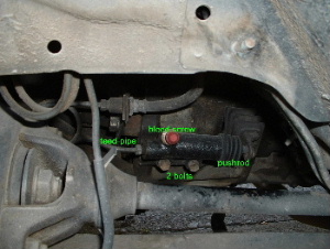

    Clutch pedal bleeding
    Can anyone give me any pictures of the procedure

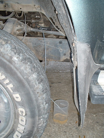

    See the pics, get someone to sit in the drivers seat and wait till u open the bleed screw, they then push down the pedal and hold while you then close the bleed screw. Do this over and over all the while topping up at the reservoir to avoid pushing air down thru the pipes.

      thanks for pics, that at least looks an easy job to have a go at.
