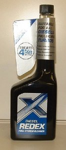

Your starting problems may just be that your glowplugs need replacing.
But try this method first; When engine is cold, i.e. first thing in the morning, switch on ignition and wait for a beeeeeeep sound. switch off and then immediately back on again and wait for the beeeep then start engine, I do this on really cold mornings and it starts better.
The smoke is just the unburnt fuel belching out after the previous attempts to start. You could also try some of this to stop the smoke......
