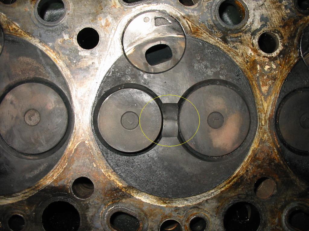

            to be honest if its cracked you will see it easy mine cracked between 3 of 4 sets of valves,,,still ran well and didnt over heat let this be a warning to you all,,,check the water in your truck every day or week.....
              Heres a pic of one
