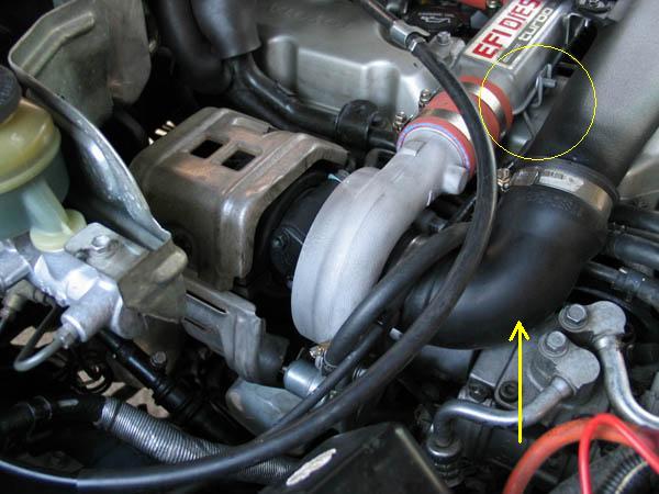

    As long as the green tubo light comes on and you can hear it whistling, I would say that there isn't much wrong with the turbo.
    I haven't heard of the oil congealing before, What grade of oil you using?
    I use 15w40 semi synthetic.
    Maybe you need an oil change?
    Remove the rubber pipe arrowed in the picture, and give it a clean out. While it's off you can see the turbo impeller and see if it's in good condition (no missing or broken blades)

                          I'm still not covinced it's your turbo thats knackered. Theres not much to them to go wrong. As long as it's spinning o.k. without squealing like a pig, (whistling is o.k.) see pic, they are a prety simple device....
                          I think it's oil/ crankcase breathing related.
