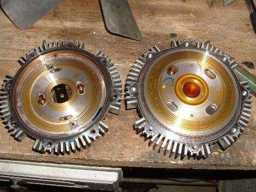

              The fan probably needs new oil. They loose it over a period of time and need to be refilled. The fan has to be split to do this.
              Mike G
                Attached
