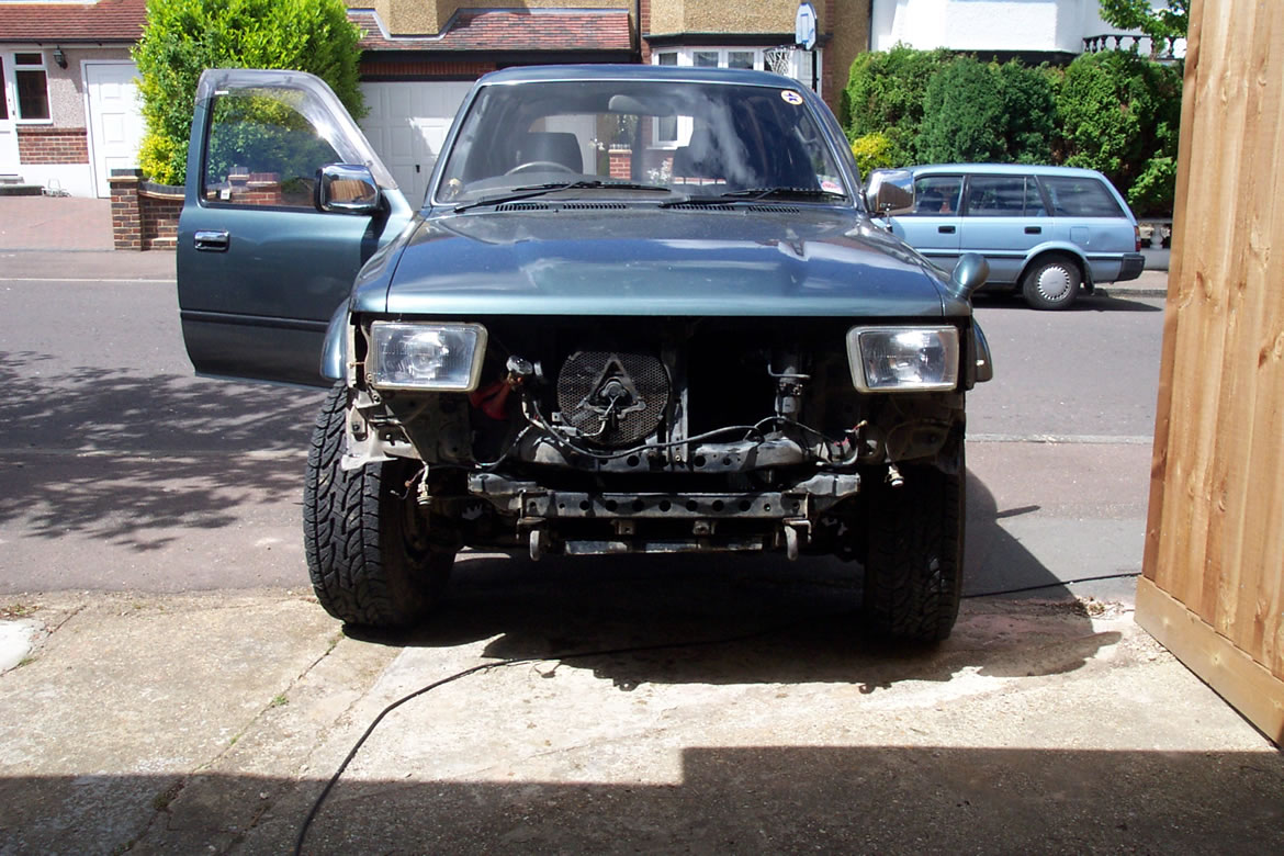

                    i never thought to run it without the bumper! going to try it, back ina bit!
                    i think my surf would look like chernobl if i tried THAT hill!
