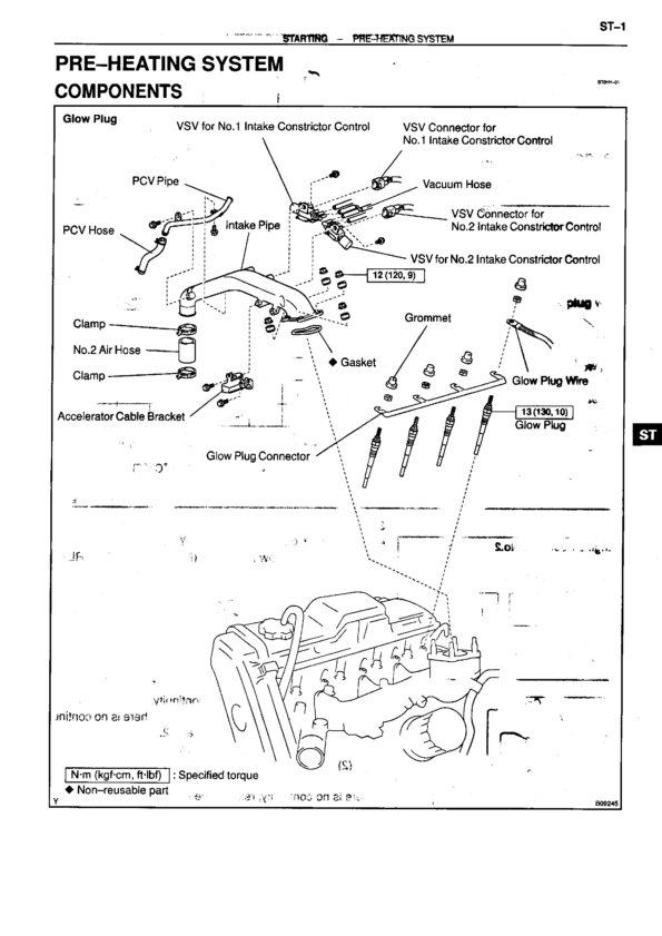

Still having problems. Garage it went to changed the relay and fuse. Turns out this is an intermittent fault and it doesnt blow the fuse everytime.
This morning whilst bridging the fuse with my screwdriver there was smoke and it actually turned the tip of my screwdriver bright orange and started to melt the metal!!
Intermittent fault - any ideas? If not the spacers?
Could really do with this bottoming today if anyone can offer any help.
