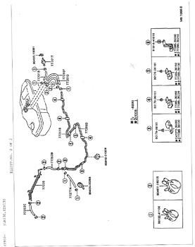

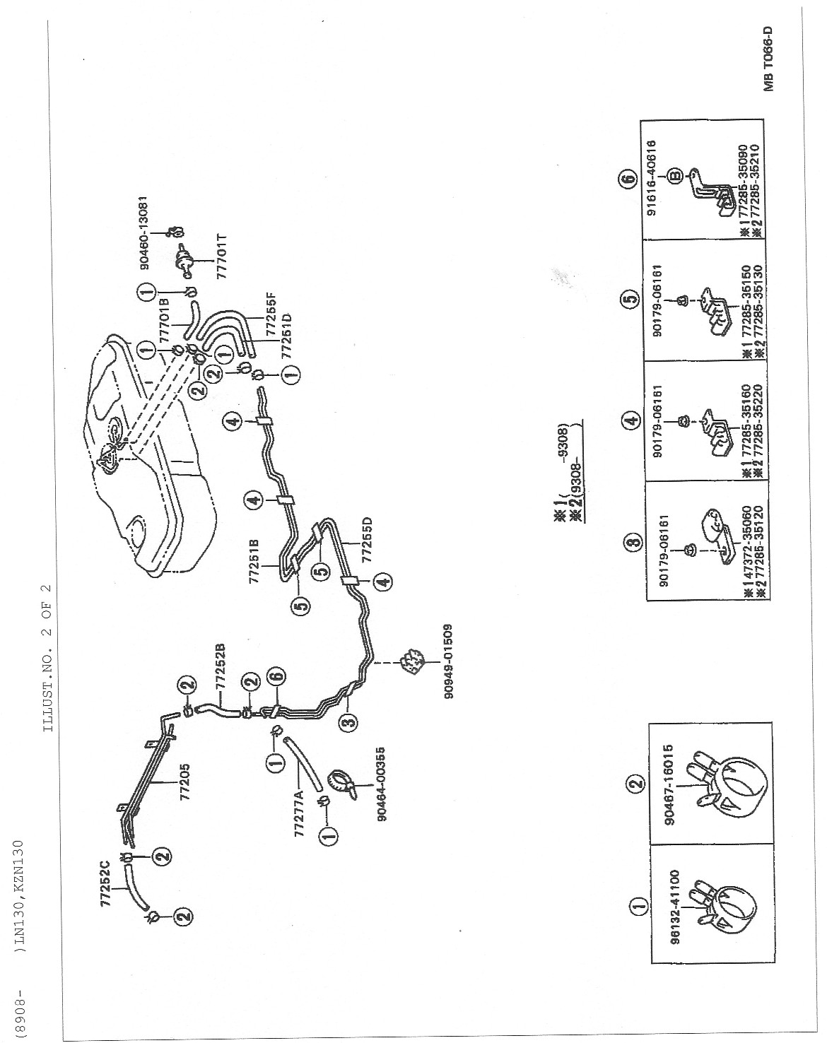

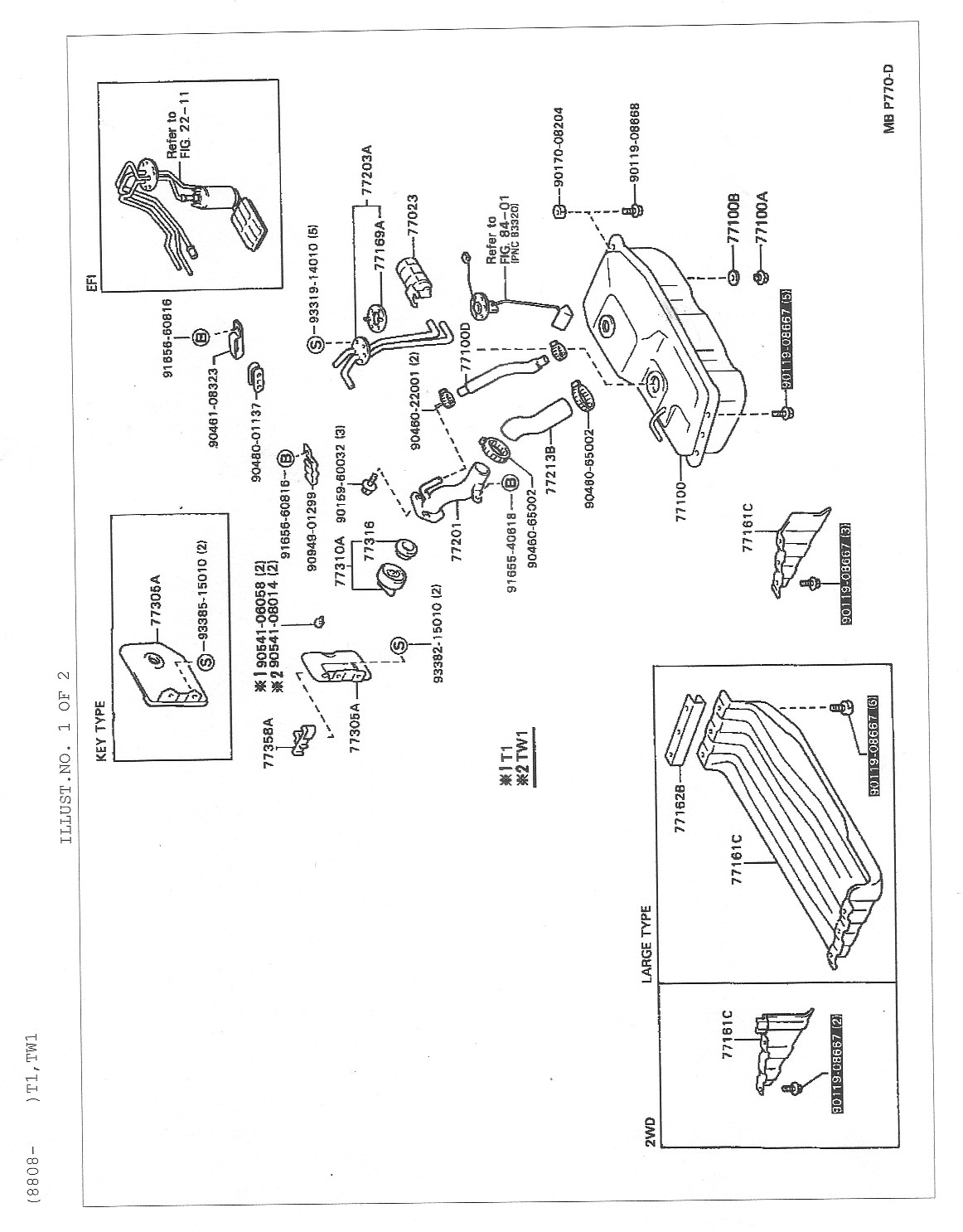

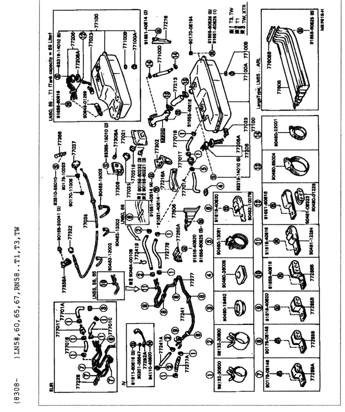

        The attachment is a scan of the Toyota EPC for the fuel system on your truck - you may be able to work out how best to get at the sender unit from it.
        I would check all the electrical connections first, including the gauge, as it may well be something as simple as a dirty connection or earth causing a bit of resistance. May be your local friendly Toyota garage would give you the correct test values so you could check with a multi-meter whether the sender is actually duff or not.

            I'm not an expert at the Toyota EPC System but the attachments are, I think, the fuel system for your truck.
