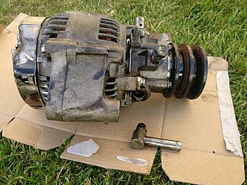

Hi there, well some months ago my Surf blew up on the motorway and I thought the old girl was a gonner at last! Due to other commitments I've only just found the problem, as per attached photo. This was a replacement alternator, only replaced shortly before the oil loss so I should have thought this was the problem. The pipe which has come away comes with the alternator - it just slides into the hole in the alternator body. It's a tight fit but maybe not enough not to come off with oil pressure. Can anyone advise whether it's a faulty piece of kit, or should I just seal it back in somehow?
Many thanks.
