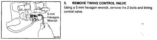

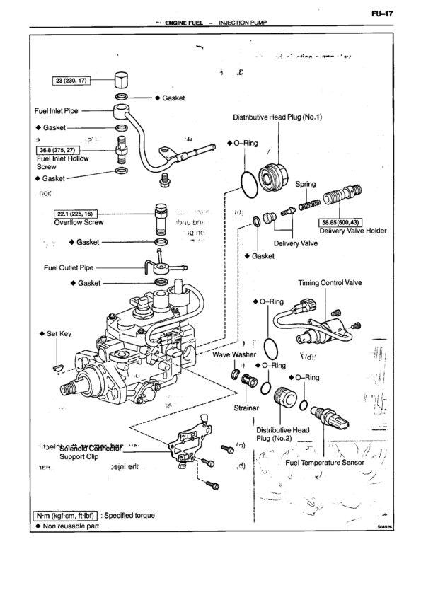

help please. my engine has started to knock(sounds like a transit) and the check light has come on. i did the fault code thing, and got code 12. can anybody tell me where on the pump is the timer control valve, coz i can get parts. but i dont want to take the pump off the car if i can help it. thanks

that is just the info i needed
