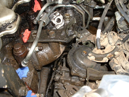

            This evening Ive got the turbo off and almost the exhaust manifold also. The 8 bolts/nuts that hold the manifold are off anyway but theres a stay under the manifold that props it up from lower down near the oil filter and these nuts look like they are tomorrows 'Toyota was takin the pi$$' half hour. Instead of battling with what looked like an impossible inside EGR pipe nut on the exhaust manifold I took the hacksaw to the pipe and sliced it across the middle, thats another half pound lighter she'll be.
            When thats finally done its over to the intake side and thats where someone like Lucky can help me or anyone else. Whats comin off exactly????
              8 bolts on the inlet manifold and thats it.
              Well almost, to get to the last bolt underneath by the bulkhead undo the three bolts on the EGR bracket to move it out the way to gain access.
              Undo electrical connetion washer assembly on buzz bar.
              For a bit more room take stat housing off thats all I can think of.

                  Grand thanks for the info. Ive taken off the thermostat housing and the glowplug stuff no probs, have the EGR stuff off and its not going back on, still I cant see how I will be able to move the inlet manifold away and off its bolts without the fuel pump getting in the way. Have any of ye had to move that, sounds like a pain.
                    If you just taking the head off you don't need to move the manifold far, most of the 8 fixings should be bolts. If you have studs the put on two nuts and tighten them against each other then you can take the studs out. You should find all the ines underneath are bolts and only a couple of accessible ones one the top are studs.
                    If you need to remove the fual pump, take off the pulley, two bolts hold the fuel pump on. One either side of it, the back one nearest the engine is a bit of a pig to get to. A longish extension slid in from under the manifold parallel to the engine is the easiest way. Next to the bolt on the outside of the pump you will see a small line on the pump housing and it should be in line with another line on the mounting housing these are your timing marks.

                      Thanks again Nigel. Thats a fine tip about tightening the nuts together and pulling the stud out, I'm getting close now. I still havent removed the camshaft sprocket coz I cant figure how to stop it turning without Toytools, there must be a regular tool everyone knows about but me.
                      Ive disco'd more vacuum parts and flying saucers and manifolds and brackets I know if I dont keep this job rolling that I'll be left stumped when it comes to refitting it all.
                        In the pulley should be two threaded holes, simply put two appropriate bolts in these and use a lever between the two bolts to hold back whist you undo the pulley one.

                          ok this is starting to drag, 2 long bolts threaded in there and a bar slipped between them and pushed clockwise, fine
                          problem is the lever bar passes right thru the centre of the sprocket hence in the way of the bolt
                          so I put the breaker bar and socket onto the 19mm sprocket nut and use just 1 long nut and lever between the 19mm socket and long bolt, the long bolt bends like a yuri geller spoon
                          this is not for DIY tools
                            It must be on tight then, you really need to wind the bolt in as far as possible leaving just enough sticking out to get a purchase on it with the lever.
                            Also try and give the socket wrench/bar a few good sharp whacks with a hammer, this initial shock often loosens them up.
