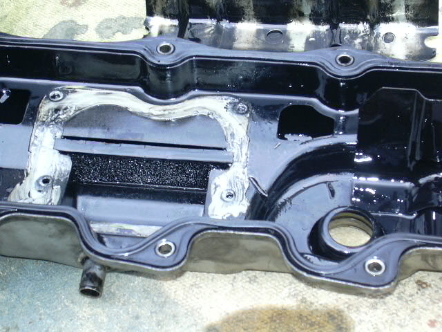

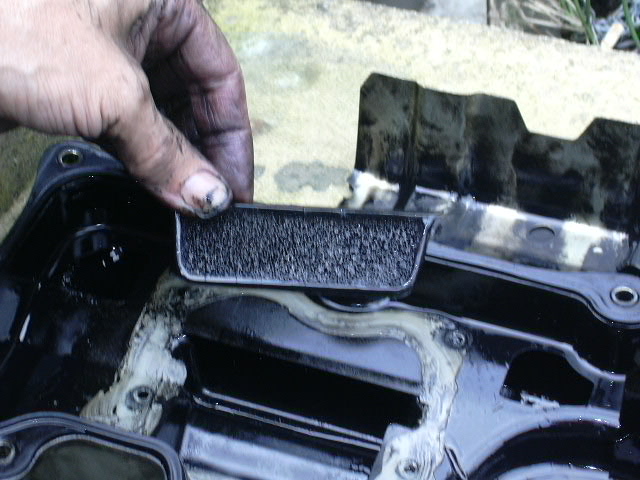

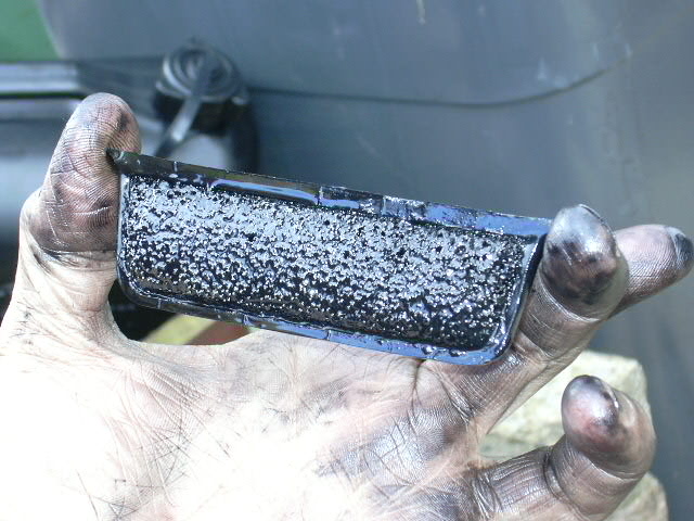

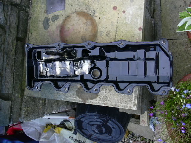

Cleaning the little filter inside the rocker cover helps. Mine was completely gunged, See piccies;
