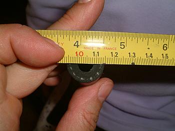

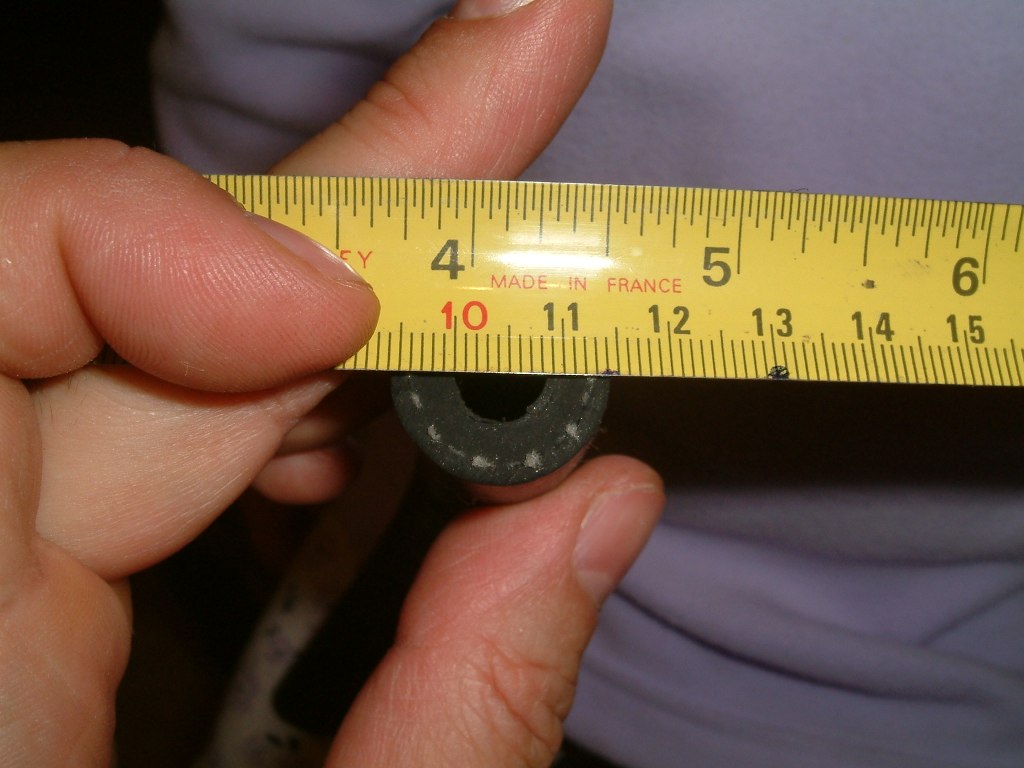

I have had an oil cooler made up with the right size bore to match the existing pipework under the surf coming from the auto box.

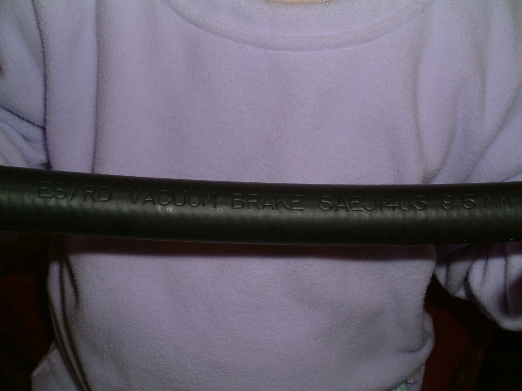

I have used the following flexible pipes to reconnect the original oil cooler and (soon) the new external one.
This is what is written on the hose.
"ES/RD Vacuum Brake SAEJ1403 9.4MM"
The fixed pipework has an external bore of about 10mm, so this flexible pipework is real tight... jubilee over the top, job done.
I bought this hose in Lloyds in South Harrow, it is something that they keep in stock.
