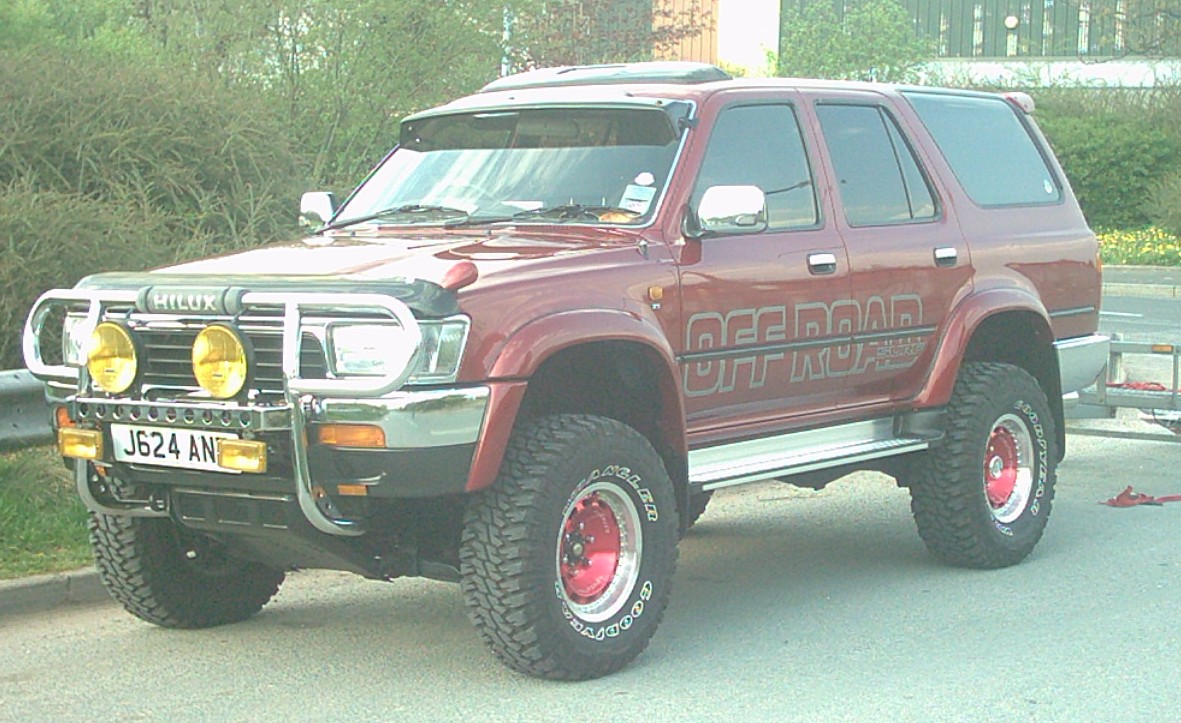

Here are some pictures of my Surf if anyone is interested: http://www.fredmitchell.com/surf

Everythng was on it when I got it, only added the A bar and spotlights externally. Might go for a 2" lift later this year, when I get over paying for the new head!Originally posted by DriverHi Mitch,
Stevo replaced the head on my Surf last December and I have not had any problems since. Just had a look at the pics of your Surf - Nice One!!
really like the colour, do you mind me asking where you got the rear light / lens covers from ?
