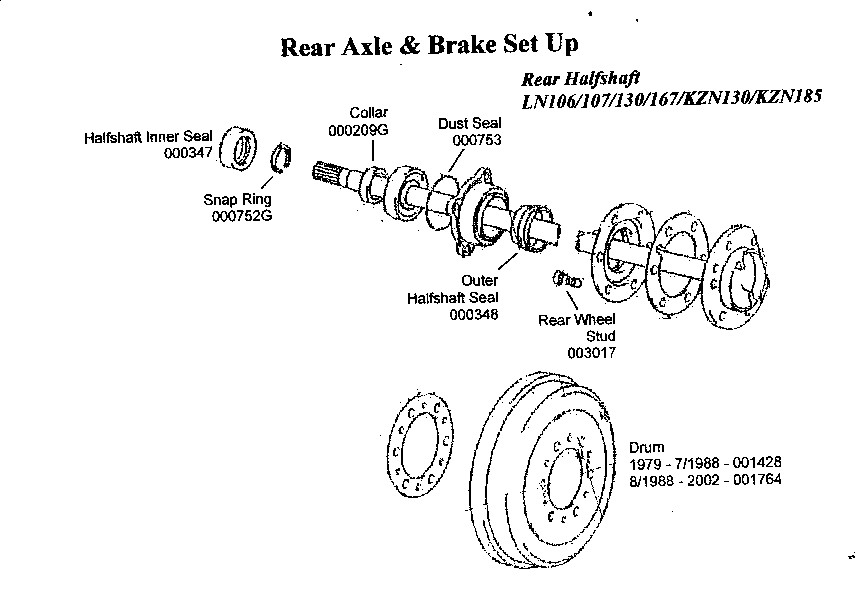

hi can eney one hellp.. i have a leak on the o/s side rear wheell, its not brake fluid, and after taking the wheel and drum off i think it is coming from a seal but am not shure, and dont know if it is ok to remove the four bolts on the other side and pull the asembily apart.. is seal is just there.. eney hellp would be apritiated thanks

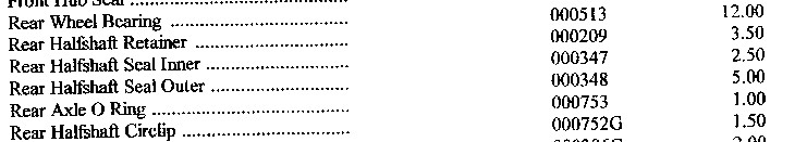

Yes you can undo the 4 bolts and pull it apart but you will also need to disconect the brake line and the hand brake cable. I had this problem a while ago and had to replace 2 seals the o-ring and found the bearing was gone as well, all parts available from milners for a round £40.I'm a custard donut monster

hi again thanks for the info.. i have looked at Millner off Road for the parts,, {Rear Halfshaft Seal Outer ,,Rear Halfshaft Seal Inner,,Rear Axle O Ring.,,} is this all i need to do the job or should i get the Rear Wheel Bearing as well,, ther has been a nois from around ther..
