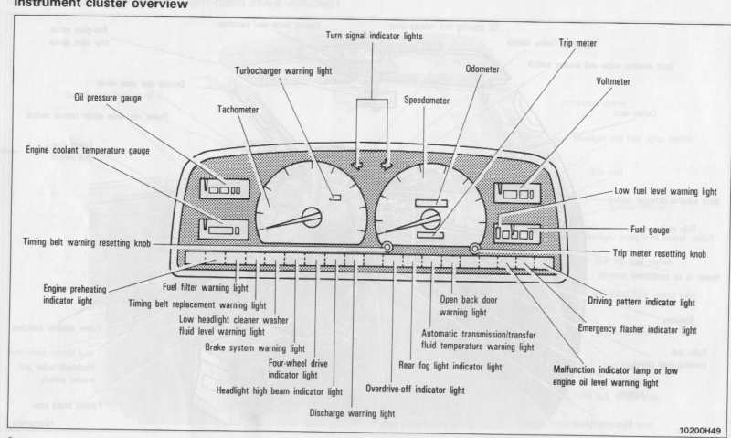

    The timing belt warning light comes on at 100,000km intervals to indicate that the timing belt (also called a cam belt) needs to be renewed.
    Once the timing belt has been changed the warning light (on some models) can be reset by removing the small rubber bung on the clear dash panel by the speedo and inserting a small screwdriver or pencil and pressing the tiny reset switch below. Not sure if its what Ur after but worth a try for the filter light.

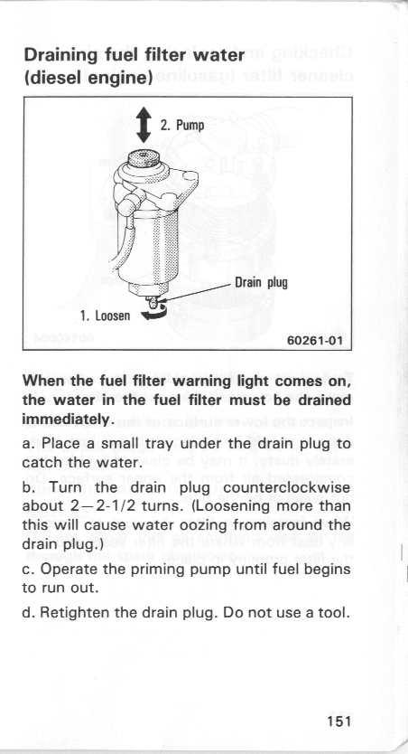

          If it has only just come on while driving then there is water in the filter.There is a small drain tap on bottom.Unscrew a few turns and allow to drain until all water is removed.Do not drive with water in filter as injectors will be damaged.
          Neville
            Heres a piccy for you
