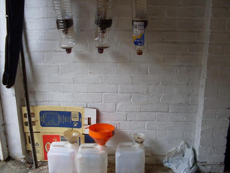

          If you are using your own collected waste veg, how do you prepare it for use?
          After collection filtered through a pillow case into a 45 gallon holding drum then triple filtered, twice through hand wipe tissue + once through coffee filter and straight in the tank
          Any other notes/ tips etc.
          For detailed discussions and a database of other vehicles see www.vegetableoildiesel.co.uk
          Pics of my set to follow....
              Pics of my setup to follow....

                              I work as a chef in sw scotland, last year when prices went through the roof i started taking the old oil home to see if i could get it clean enough to use as fuel, first i asked a company that made it for the trade, they told me that depending on the vehicle it could be used anywhere from neat to a mix of 20%oil/80%fuel.They where not prepared to tell me much more.
                              They also charged 5p more than diesel was anyway.(but its greener they said.)
                              Anyway, one day the fuel went up to beyond £1.80 per gal so i decide to bite the bullet and tried it.
                              I let the oil settle for a few days, try not to move the tub the old oil is stored in, lift it out with a jug or something, the first filter i tried was a normal funnel with a metal gauze in the bottom, just not good enough, plenty of debris was visable.
                              Then i tried a pare of womens tights with very good results, although i did this three times just to be sure. This was the first batch i used and had no real problems, i used a 50/50 mix, it just seemed a bit lumpy starting on the cold mornings, so i changed to 40% oil/ 60% diesel and it started and ran as normal. i have been told to use a thinner eg: petrol or an octane booster at a 5% ratio of the entire mix, i have not tried this yet as i have no problems with the mix and i like to keep it simple.
                              Since this i have used musslin as the filter, (we use it to strain sauces) you can get from any fabric shop at about £2 per meter, this gives the best result but takes alot longer so set up you aparatus pour in the oil and go for a cup of tea.
                              Things to note..
                              • I have been told this can not be used on anything after 1998.
                              • This is a VERY MESSY process.
                              • buy law you can make and use 10.000 ltrs per year tax free.(woohoo)
                              • Check or change fuel fillter more often.
                              Hope this helps, there will be thing i have not remembered so i will try to post again when i get some time.
                              cheers all, OZ.
                              P.S the price of cooking oil has doubled since people started doing this, end of 2007 price was £10 for 20 ltr now its about £23 per 20ltr.
