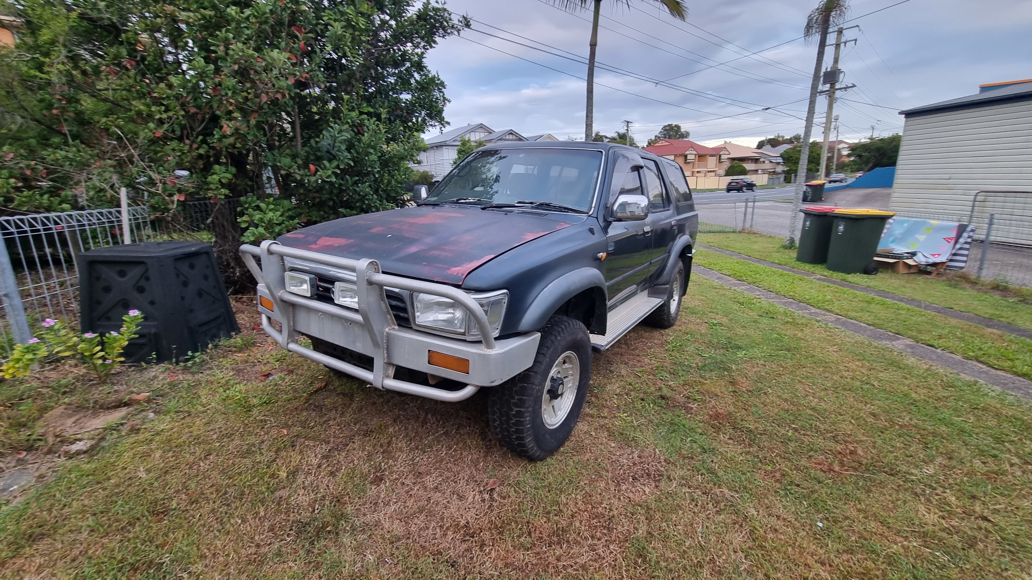

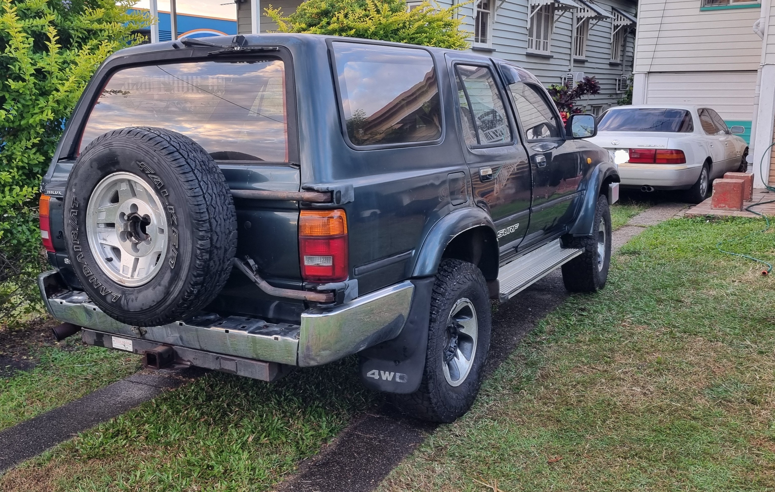

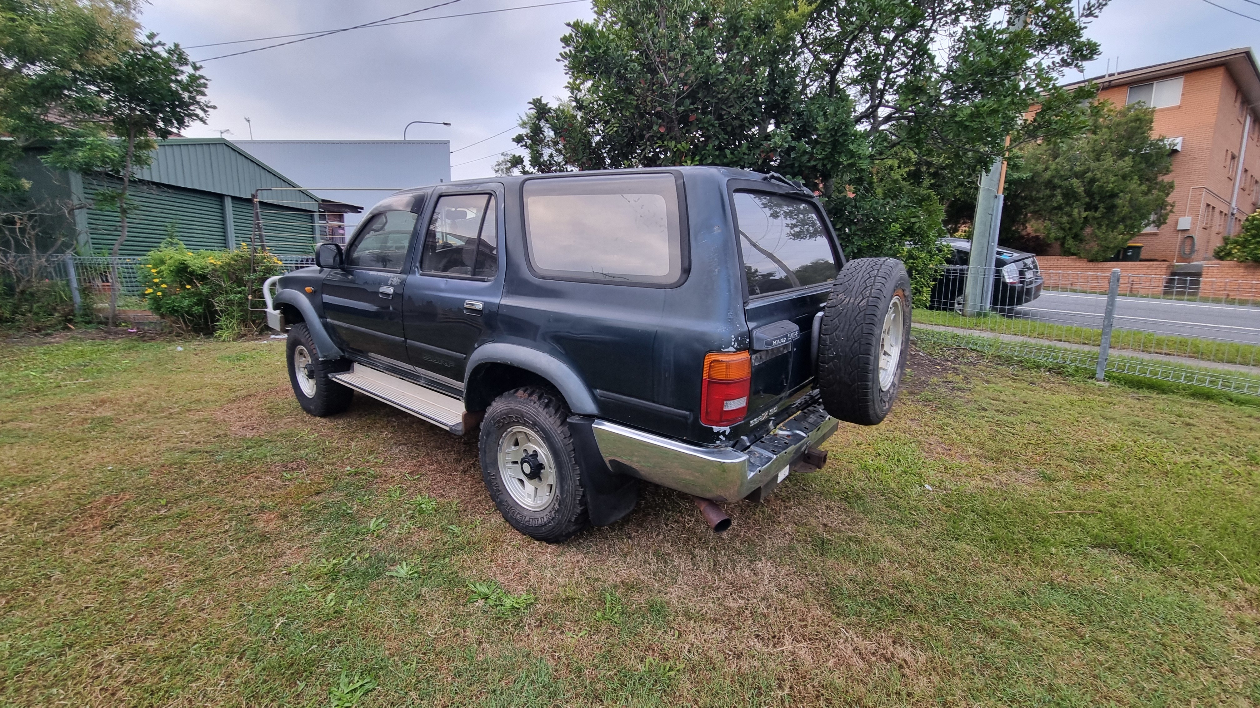

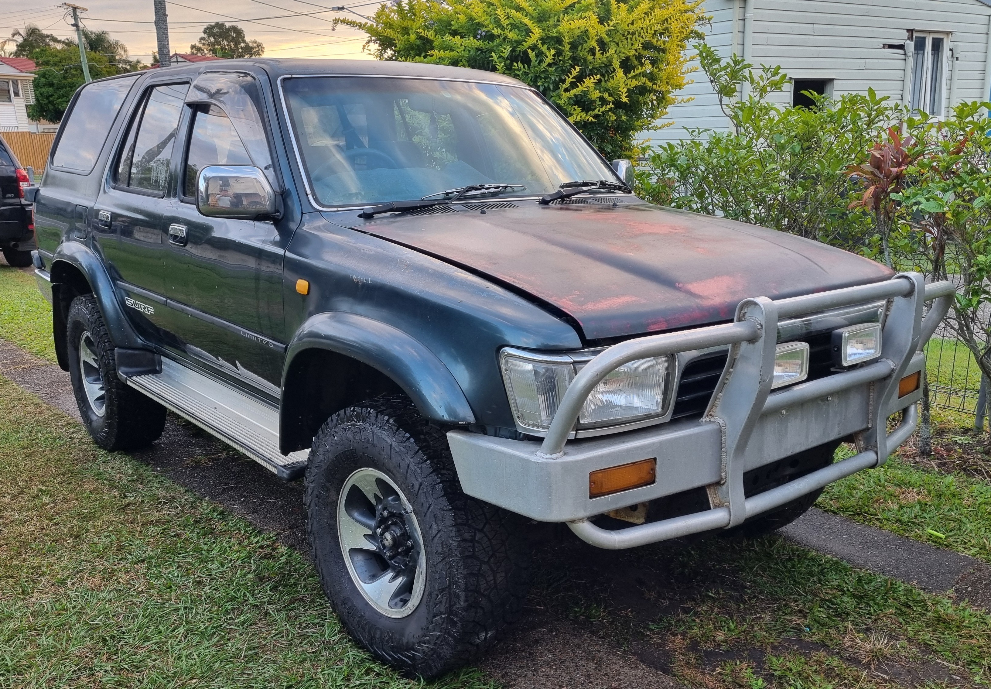

Previously had a beautiful red 89 LN130 manual with a red interior and all. Was a narrow body, but it was in excellent (except faded pant on the bonnet and roof) condition. Didnt meet my needs at the time and very regretfully sold it.
Keen to get back into it all I spent months waiting on the right Surf for me, I came across one about 2-3 hours drive from where I live and bought it at a steal.
A few issues with it running but I think I have solved it. More details soon.
It's green, the bonnet isnt original and there are a few things to fix on it but my main goal right now is getting it driving reliably and registerable.

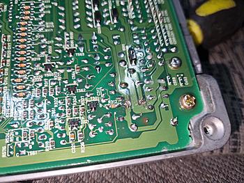

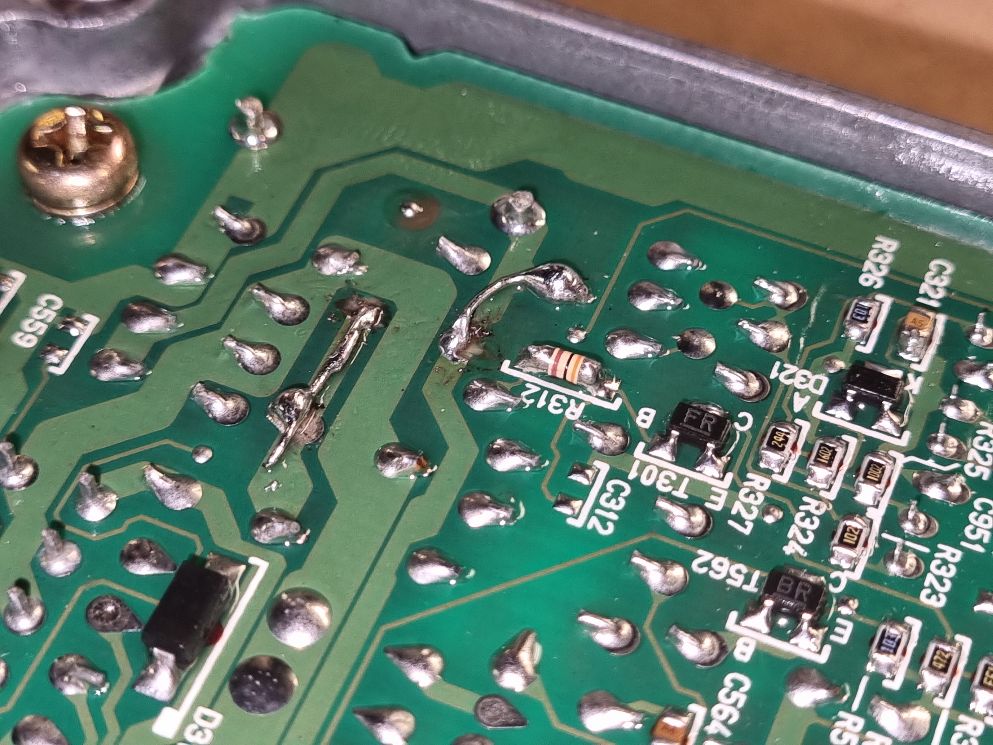

So, I bought the car with a running issue. The engine is mint, doesnt rattle or make any strange noises. It appears to run very well but was every now and then cutting out and sputter, when it did this there was a clicking relay noise under the dash in the kick panel. Trying to diag this was a pain because the car would only do this sometimes and the relay noise was hard to hear. When I had a screwdriver on a relay it would run sweet, when I looked in the engine bay it would sputter for a split second, but still remain running. Very rarely would it cut the fuel. I started pulling relays to try figure it out and the only one that seemed to have made a difference was pulling the ECD relay. Trying to find information about this was difficult as either old forums had been taken offline or not maintained and other details went on other tangents.

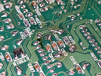

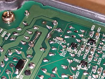

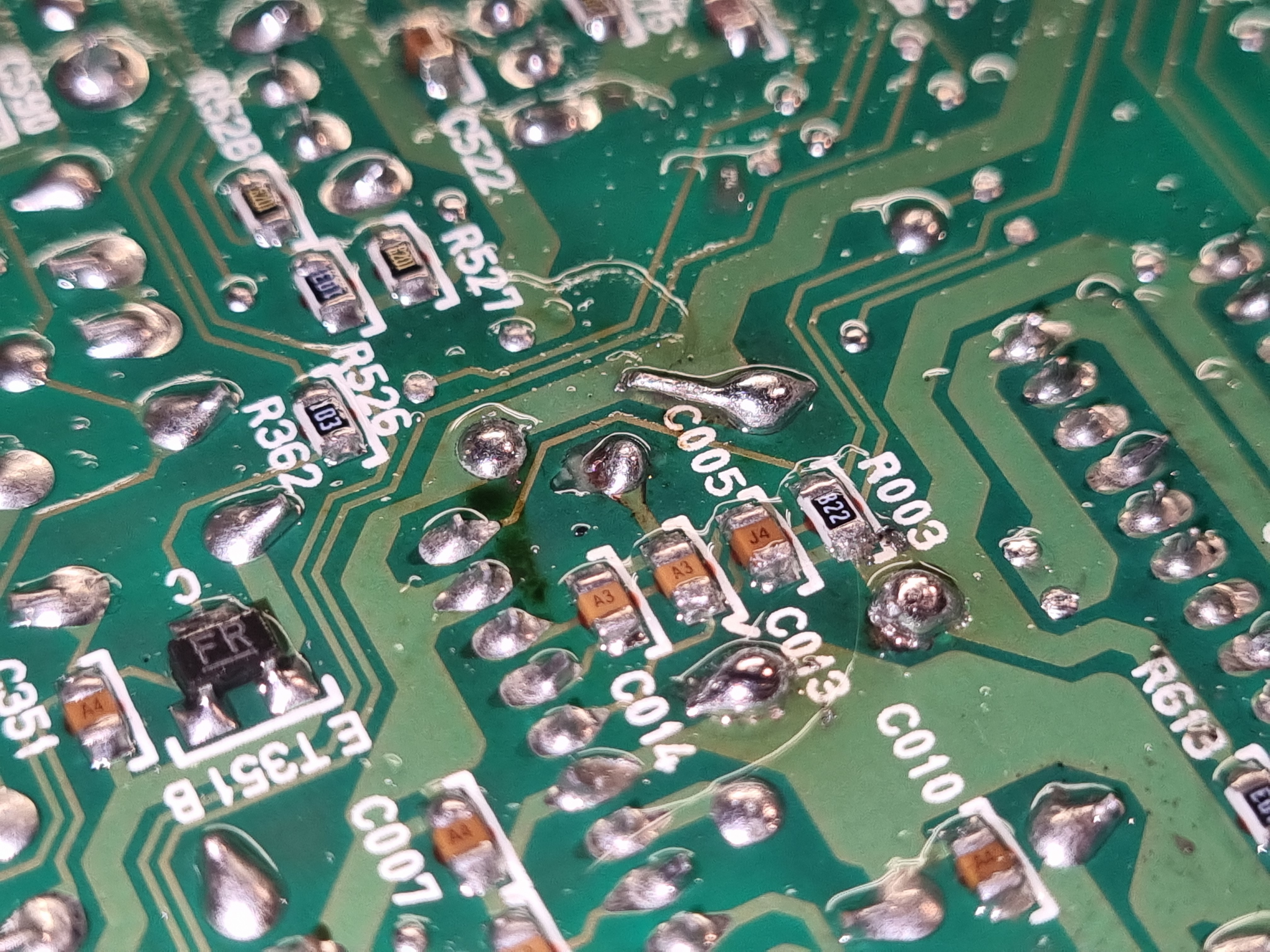

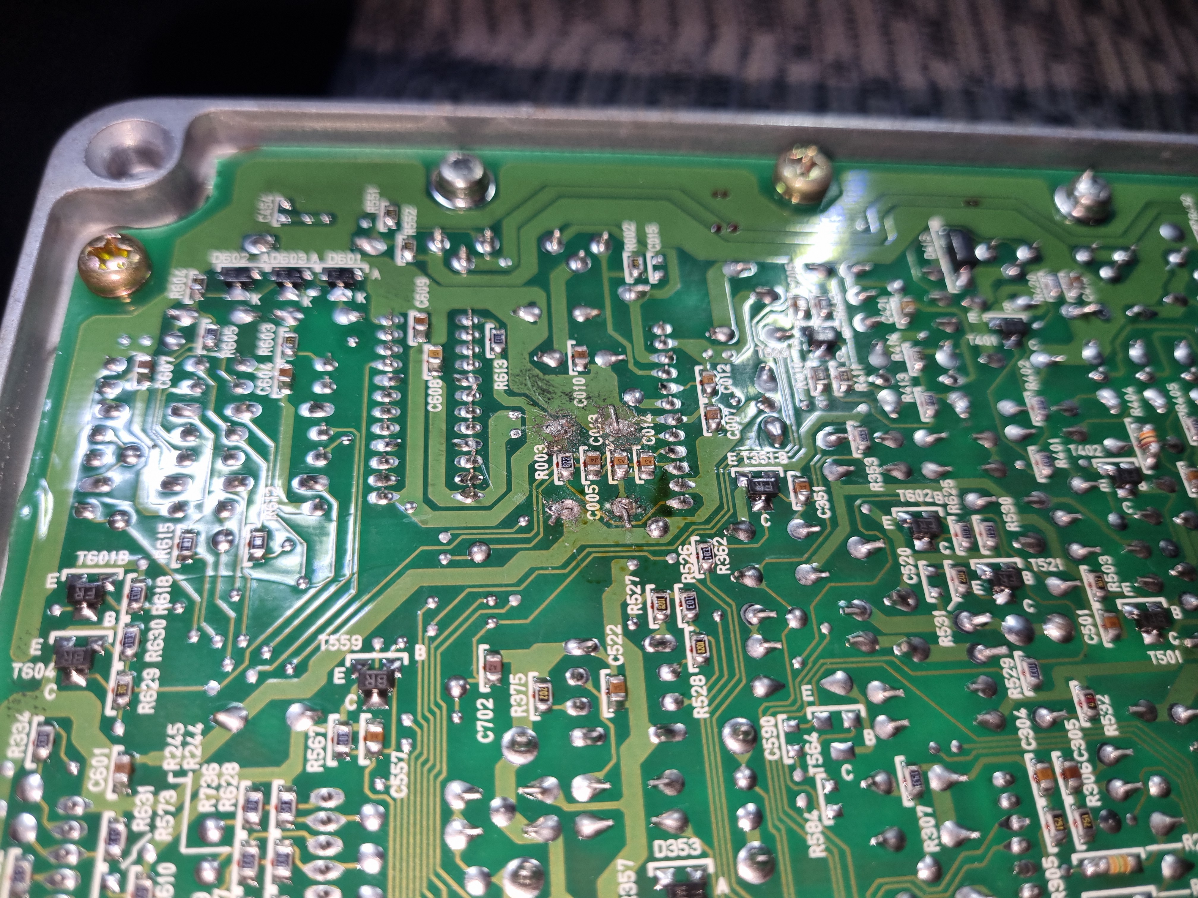

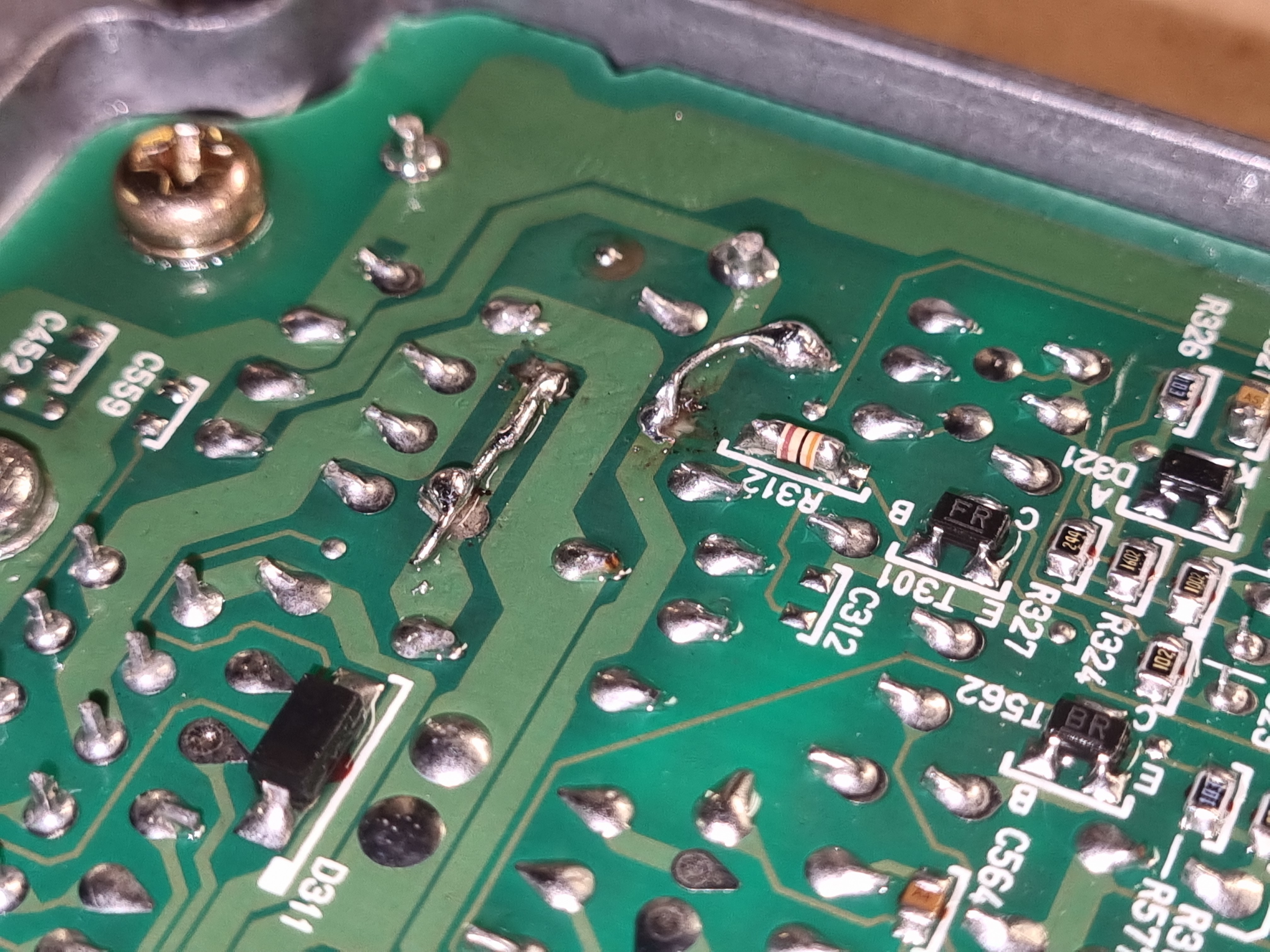

Something I noticed constantly was posts saying just check your ECU, if you are having problems or not just check it. So I pulled out the ECU, familiar with issues from a lot of Toyota ECU's from the 90's and early 2000's (I also own a 89 Toyota Celsior and 2005 RAV4.2). I pulled the ECU noting that 2 bolts were not quite tight and there was some electrical tape on the ECU, any way I cracked it open. Low and behold there was 3 capacitors that stood out like a sore thumb (see photos). Surrounding these 3 caps were remnants of leaking caps. But there was 3 brand new caps in their place. These had been replaced before but who ever had done it, did the worst soldering job I had seen to date. So I pulled out all my soldering gear and carefully removed one cap at a time and cleaned up the surface before replacing the caps and using god's gift, leaded solder to reinstall them, noting on removal that 2 caps had been installed reverse polarity.
Cleaning them up and reinstalling the capacitors was easy and cleaning up any residue was hard. It was caked on and pretty resistant. I cleaned them up the best I could, let it air out and installed it back into the car the next day. Fired up first time like always and left idling for well over 30 minutes without a single hiccup. Bridging TE1 and E1 gave me constantly flashing (no codes stored). I just about jumped out of my seat in excitement and couldnt wait to tell my wife and father.

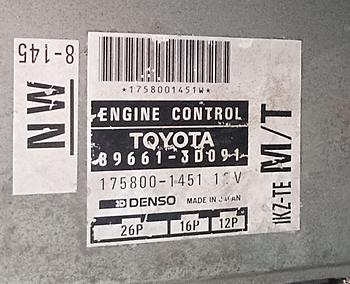

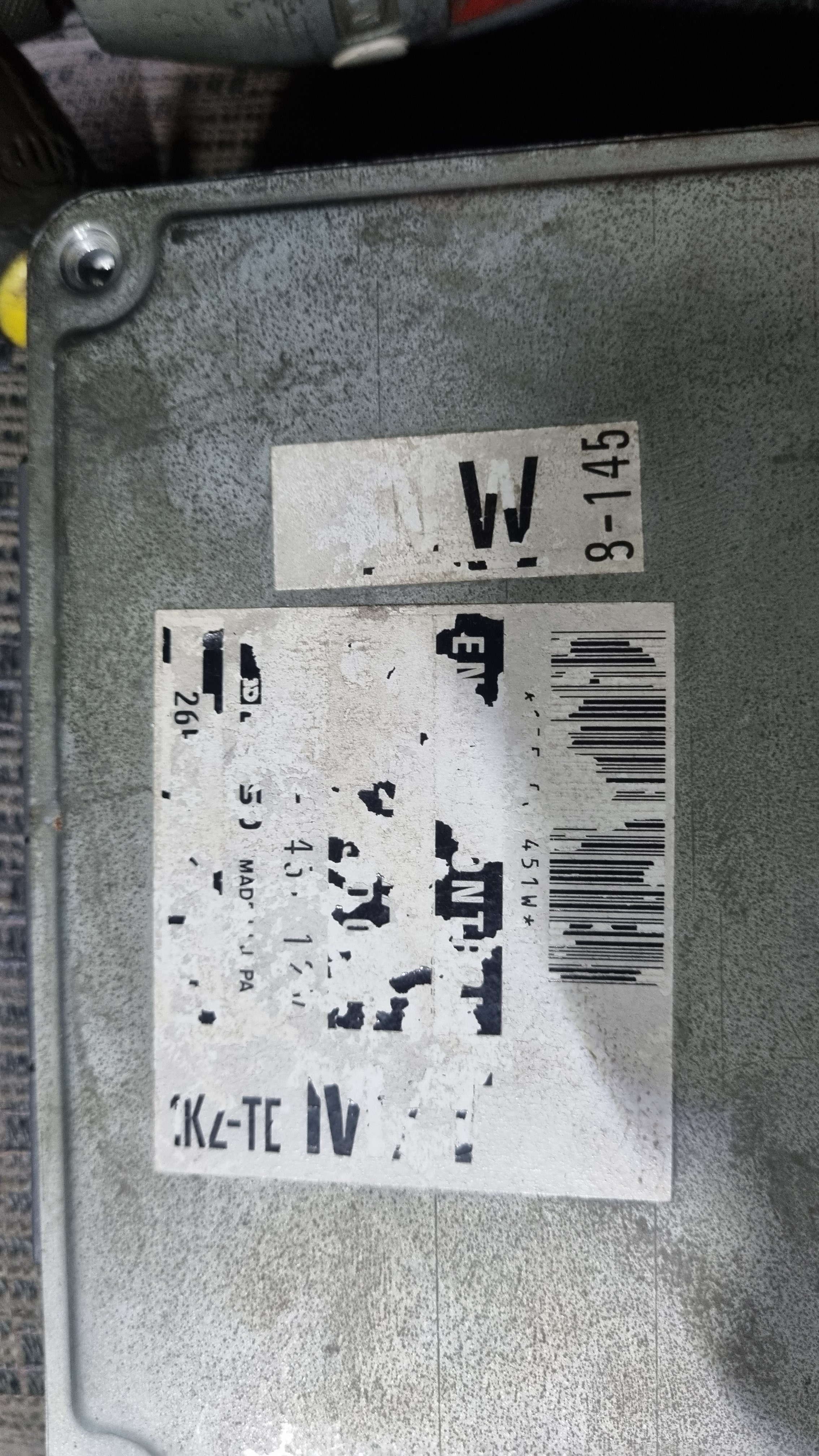

I do want to try identify the exact model of ECU I have, as most of what I could find online is of auto ECU's. I have attached a photo of what's left of the label and ToyoDIY seems to narrow it down but I can't confirm.
