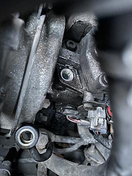

    Hi have had the exact same . Toyota Ayr head mechanic used to be in south africa so great knowledge . The fuel delivery pipe into pump remove banjo and bolt there is a 'w' shaped circlip . Remove with narrow pliers then pull out the 2 inch long filter . Clean. Also go to rear passenger side of pump there is a sensor then a large nut remove then u will find a stubby filter about 12 mm long. This is the one that was blocked with long fibres. Toyota had no idea how they could get in there. Normal running now resumed but there was a bonus. A significant power increase.
      Hi there thanks for your reply could you possibly explain a little more we found what we think the banjo is from the fuel supply removed banjo but there was no W circlip or 2 inch long not sure if we are looking in the correct place we are looking in the fuel pump under the bonnet as shown in picture would really appreciate I little more info if you can please. thank you.
