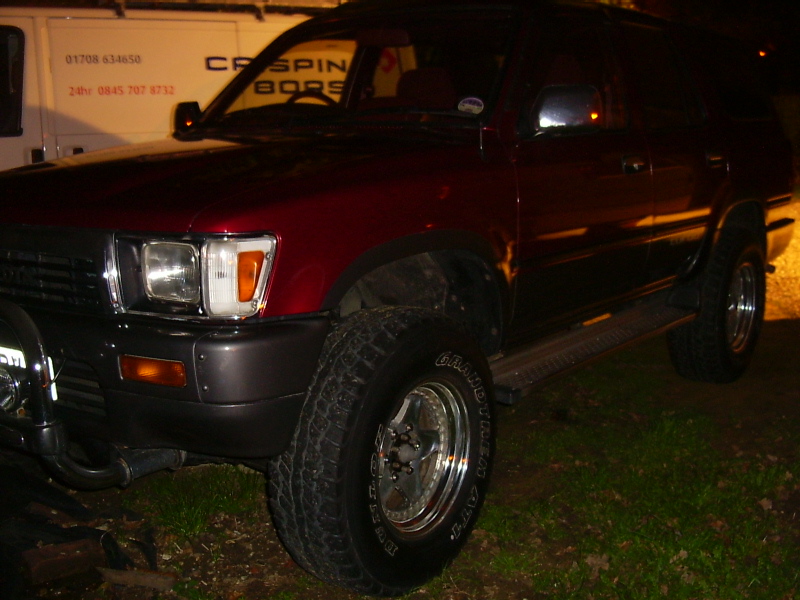

          They fit!!!!
          Had to give it a go so bolted them on tonight, not much clearance but they do fit, i will be giving it a 2" lift and some arches soon to complete the new look, i am well pleased with the wheels. will take a better piccie in daylight.
            that your van in the background? if so you may well share my surname

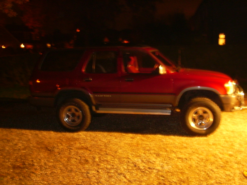

                Fitted the 2" lift springs today from LA Supertrux, they certainly work, also tweaked the torsion bars a bit to give about 1" up on the front.

                  Hmm, need ot get my 2" raise too, looks ok, but went ot see tonyN and Linda today and reckoning that the back is sagging a bit. Might as well get the lift springs while i'm at sorting it out. Onwards and, well, UPWARDS i guess. Pictures soon, it's looking kinda good...
